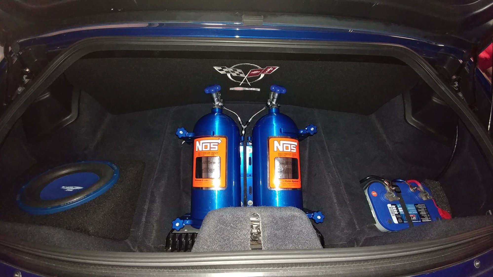

I currently have a HCI C5Z with a direct port NO2 set up that I have a lot of time and $$$ invested in. I love the nitrous set up and was going to add a A&A VS3 T-Trim kit into the mix. But now I'm thinking about a turbo/nitrous combo. Just want to see if anyone has any experience with a LS turbo/nitrous combo?
