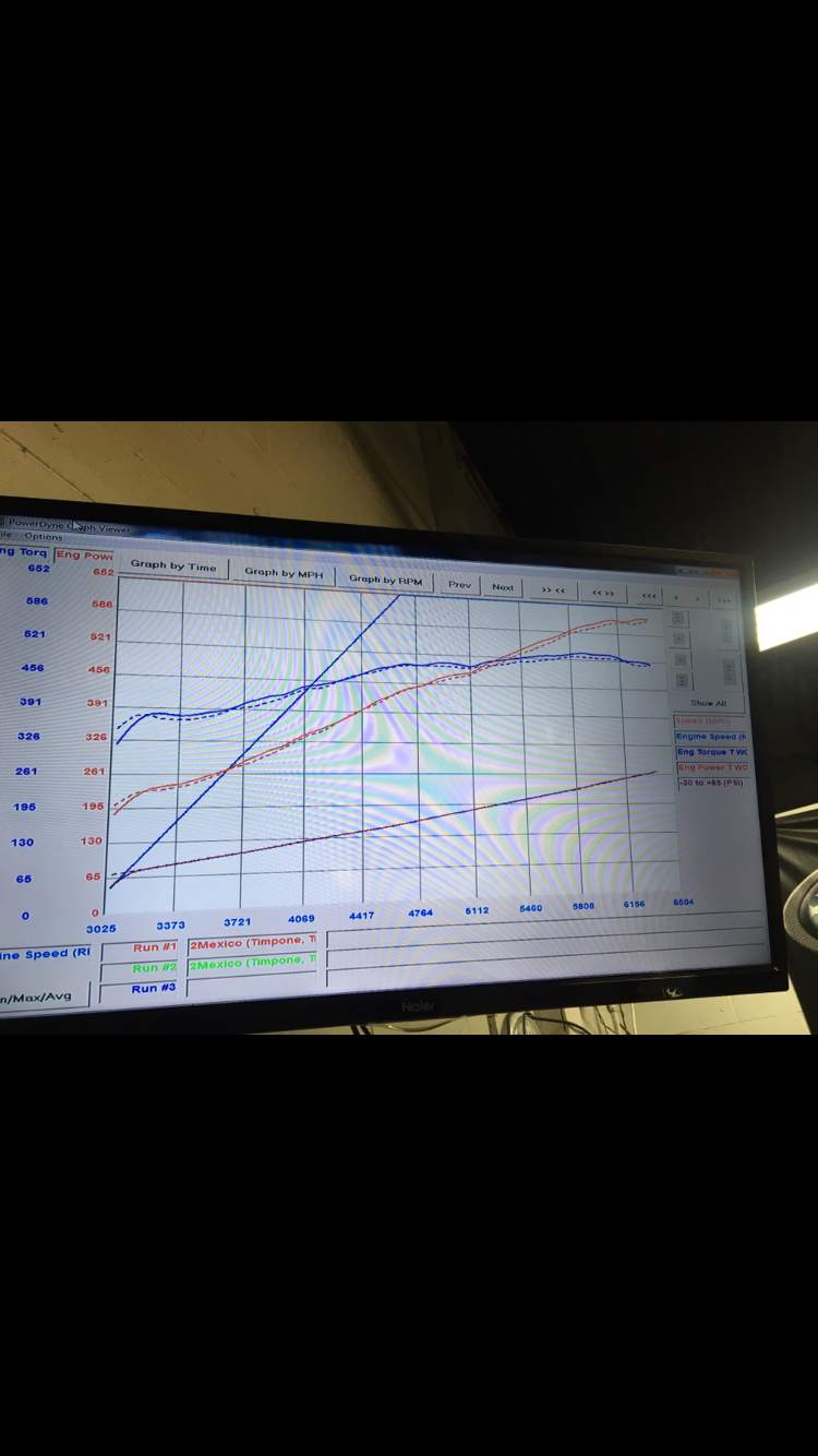

I'm at 670 rwhp on a Mustang Dyno with a stock bottom end LS6. 4th summer IIRC, WOT every time I drive it (weekly). Risky? Sure it is, but if it goes, it goes.
