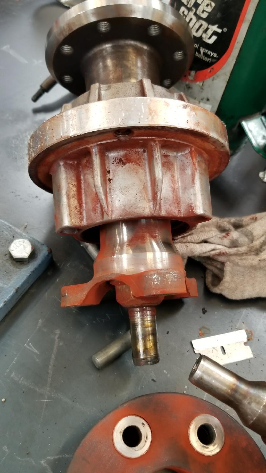

hmm, I have the same ones and recall a couple of those sleeves in mine being loose when I installed my driveshaft which was the first time the couplers were removed since first being installed... I didn't think anything of it and put them back together on the new driveshaft and it has been fine so far... the polyurethane they use is so rigid I didn't think it would ever pose a problem and I didn't want to go with aluminum couplers because I thought that might be too harsh but if the dss will fail then aluminum seems to be the only other option I can think of as far as couplers go or get a 3.5" driveshaft that eliminates the couplers altogether... I'm interested to see what you go with as a solution and if you can get any pics of the worn couplers that would be cool
here is a few pics, if you look close you can see the gap between poly and sleves, one of the sleeves came out with bolt stuck to it. All of the sleeves are loose and could be pulled out of coupler, it's interesting they are two piece sleeves, it is also interesting how much rust dust is all over everything. Did yours look like this? I may start a new thread with pics and different title to get more feedback.

I was going to ask what all the rust colored stuff was, that's very strange... do you have any idea where it came from??... mine didn't look that way when I installed my driveshaft, they looked just as they did when I originally installed them... if you take the sleeves out do the holes look out of round?

I was going to ask what all the rust colored stuff was, that's very strange... do you jave any idea where it came from??... mine didn't look that way when I installed my driveshaft, they looked just as they did when I originally installed them... if you take the sleeves out do the holes look out of round?
Yes, I did not take pics, they were sent by my mechanic, the pics with sleeves remove were too blurry so he didn't forward them to me but I did see the couplers first hand and the holes were very uniform and round just like you see here.
I'm told the dust is metal. The only thing I can think of is from metal from sleeves spinning/ vibrating and once loose easily turning to rust.......very humid hear
The bolts were very tight, only play was sleeves inside couplers when you wiggle splines?
I wonder if they can be too tight? And mash the two pieces (sleeves) together and almost act like a solid coupler and maybe too much vibration? They were so tight one of the sleeves was stuck to the bolt washer and had to be pried apart. I hope someone has seen this.
