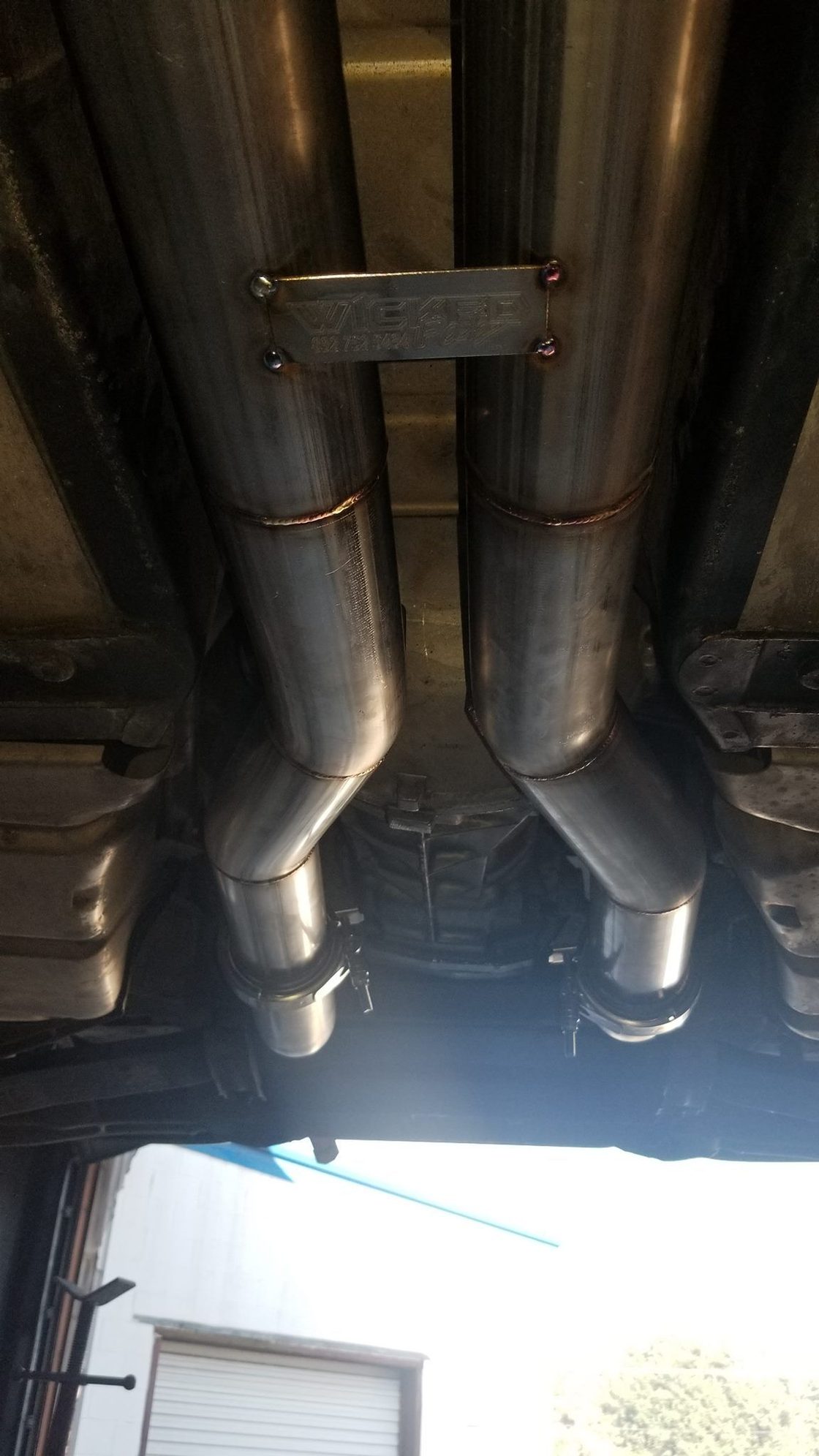

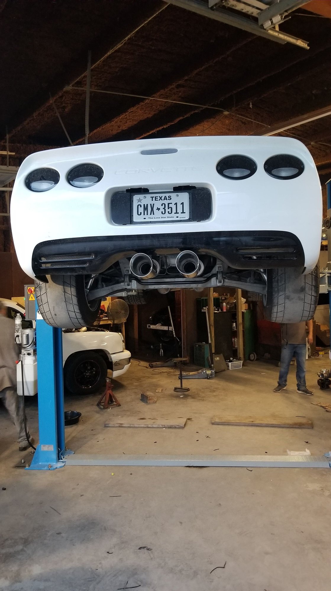

Here are a few pictures that were sent to me by the owner/fabricator doing the exhaust work on my FRC. I had found a Kooks full 3" x pipe but it didnt have the flanges installed on it to bolt onto my headers for some reason. Instead of cutting it apart to install the flanges or pulling my headers off to v band both we decided to just use my existing kooks x pipe and cut the 2.5" section off and start the new exhaust from there.

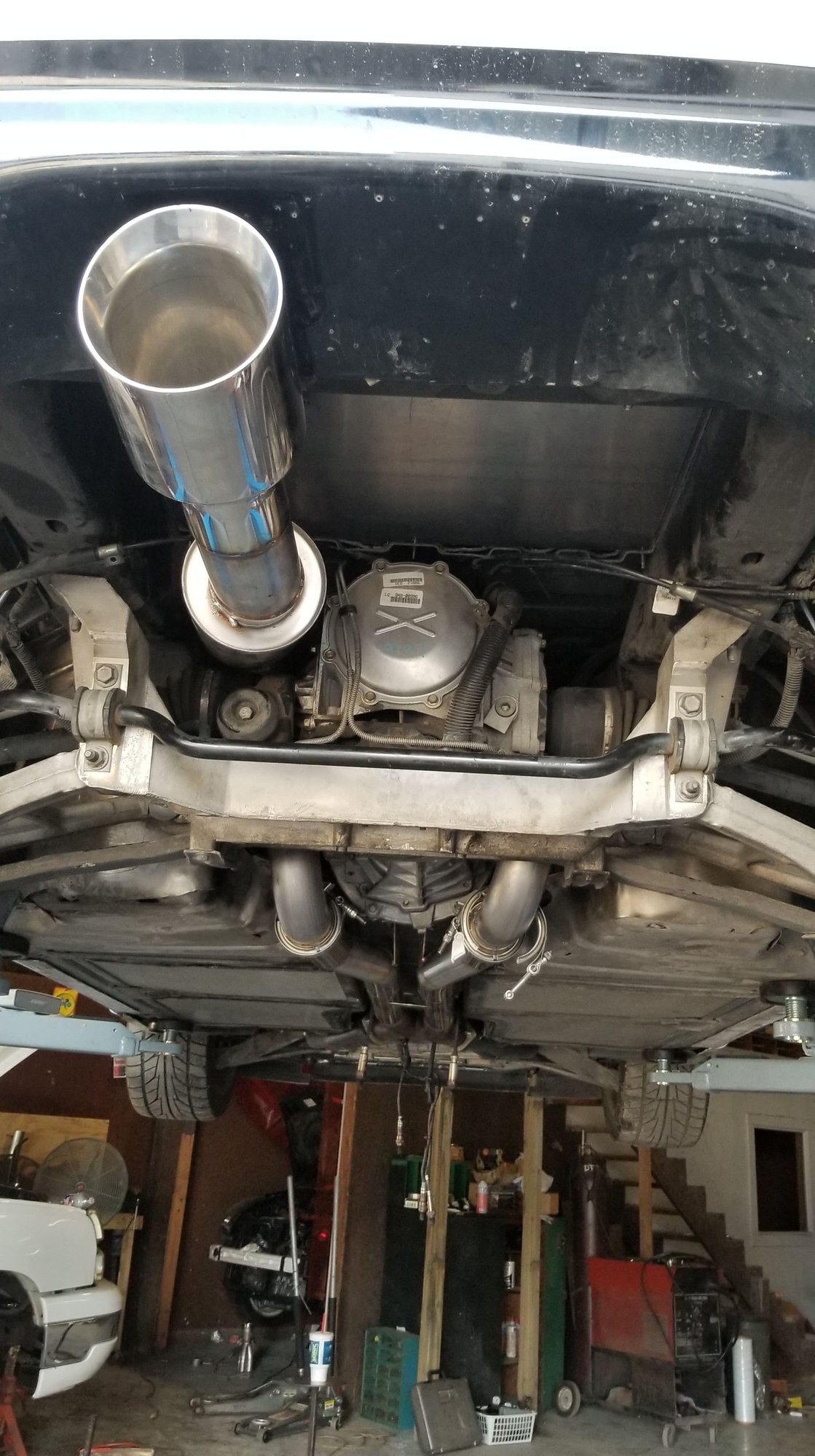

I also had purchased a lg big 3" axleback but just didnt like the design/layout and the way it made the u bends like the stock exhaust. So I took my grinder and cut out the trunk tub and made a plate out of aluminum to cover it up and give me all the room I needed.
I chose the Borla xr1 mufflers because I have one on my fbody and liked the sound of it. The new piping is all 3" stainless with v band connections and the tips were something my friend had sitting on the shelf at his muffler shop.

Looks and sounds great. Welds look very good too! What supercharger kit are you running?

Interesting. I'm wondering if you could run a C6 exhaust after modifying the floor.
I'm not a fan of the snake routing on the C5's under the trunk. I have the idea to come over the axle then 45* to a muffler then a turndown hidden exiting on the corners of the rear bumper. Simplify the routing but not sure if I'll like not having tips in the center.

A&A bracket and secondary driving running a Procharger F1A head unit.
Ive seen someone else run a C6 exhaust after they cut the tub out also.

Man that looks nice! And yet another vote for me to cut that useless tub out of the rear of mine.

These mufflers do not fit the other way? I dont like the idea of cutting up the car...

Looks and sounds great, what part of Houston? I would love to check out the removal of the trunk tub.
