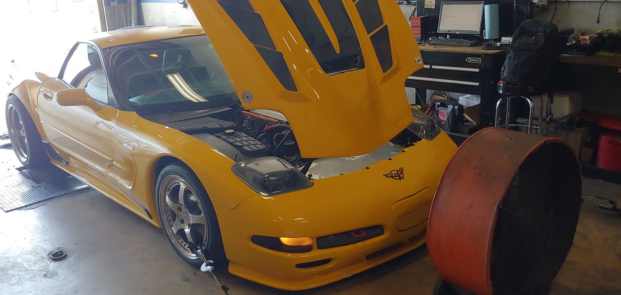

I finally fixed many of the issues that I encountered over the last couple of years, that other shops couldn't figure out. Like MAP sensor, pins touching each other causing intermittent electric short, injector harness causing misfire, missing wastegate bolts, loose bolt from exhaust manifold, loose turbo exhaust clamp, fuel pump overheating due to small vented hose and others issues. So after a few thousand $$ spent on shops and been so frustrated, that I was about to sell my car, I decided to start working on it myself after countless hours of watching youtube videos and forums reading on how to fix things etc. For many of you, it's a piece of cake to take the engine apart, put back together and tune the next day, but for me it was a challenge every step of the way. So now after this briefing, I got the car back on the road the way it was before with the exception of the LS2 throttle body which decided to give up on me. My car was always tuned at 20psi making over 1k rwhp but as soon it hit 14psi it goes into limp mode, my tuner told me that I should change to LS6 OEM TB, he tried everything to make it work, changing value, air flow, tables etc. So what are you guys using for throttle body? My car is a 408ci 62 twin precision turbo with custom sheet metal intake, 750 Pro magnafue single pump and 1650cc injectors.

I recently installed back OEM LS6 TB and went for ride, no codes or limp mode at 15psi, actually the throttle response is sharp now. I am waiting on dyno time to bump the boost to 20#.

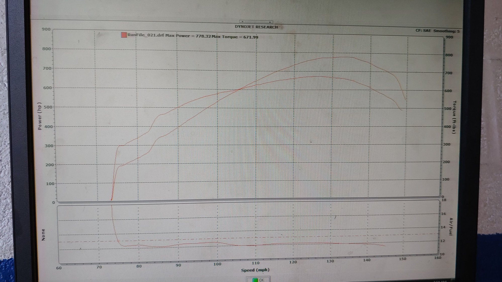

Update: I took my car back for dyno with OEM LS6 non ported TB and all the codes and limp mode was gone. For some reason the LS2 90mm TB gave me a lot of headaches. The first dyno was without changes anything from previous run with 90mm TB, it made 778rwhp at 13psi and before it was 730rwhp. We up the boost to 20psi and end up at 894rwhp with 17* timing and little rich on top. For some reason the Alky methanol was set to spray after 15psi and turn green right away and not at 20psi. So I couldn't add more timing.
