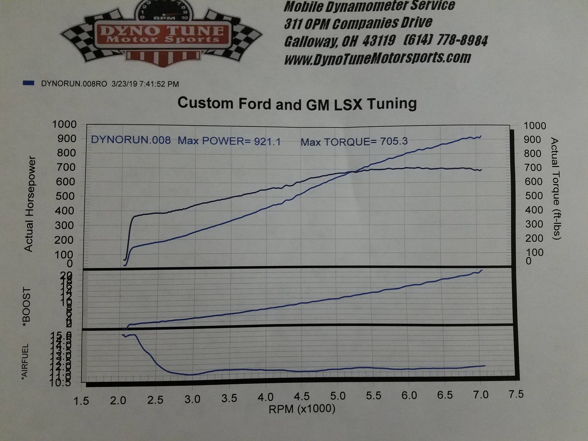

Like everyone else said depends on alot of variables. Here is a ysi with a 3.33 pulley and 8" crank.

Appreciate your time to post your results, that’s what I’m interested in.
