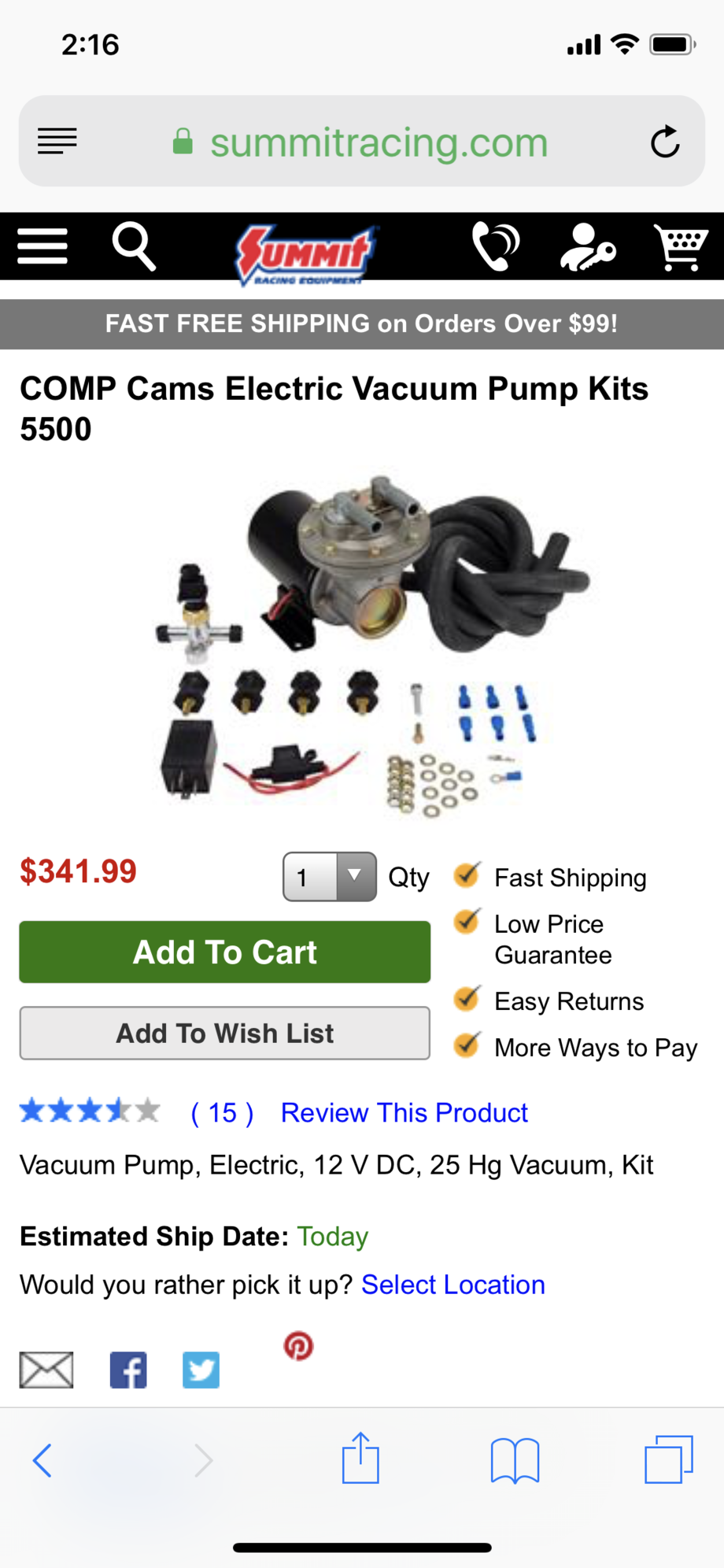

How about an electric vacuum pump ?
Who makes one?

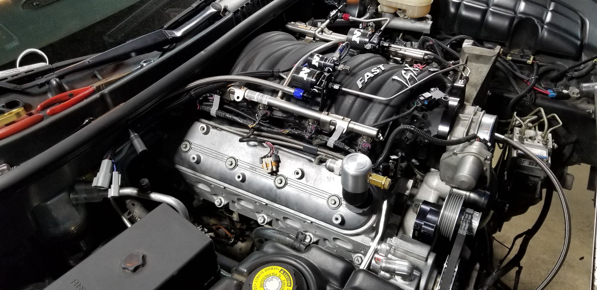

I made a bracket and installed on the otherside and used a gz motorsport idle pulley to connect the belt.

I have that electric vacuum pump on my car. I put the power to a toggle switch To limit the pumps run time. I Activate the pump in the staging lanes or right before I’m going to get a foot full of boost on the street. I also added a -12 into my passengers side valve cover into a vacuum can. The vacuum pump is tied into each valve cover with a -8 line.

Do you happen to have a sensor to know how much vacuum it’s pulling?
Pete I believe that kit comes with a manual relief like the GZ setup I bought from you..

From what I have seen though, it doesn't have great reviews. Not sure how those people use it though. I have just seen most electric pumps to be noisy and fail quickly.
