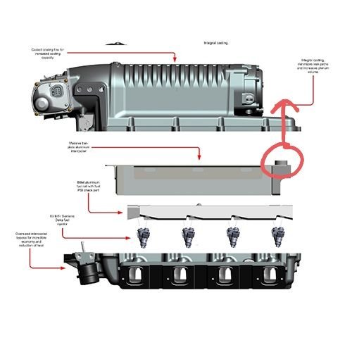

Has anyone ran a 2.9 Whipple on a C5? I know they sell a Cathedral port kit with a Y-Series belt drive, however I haven't seen anyone else run one or seen it on the forum.

Do you realize how big the 2.9l whipple is?

Absolutely, I saw a guy a picture of a guy that managed to fit a 3.3 Whipple in his C5 and it seemed to fit alright, minus the height. It didnt look like he did any cutting of the area below the wipers like what is required for an LSA blower. The main issue I was having with the idea of going LSA was the lack of smaller pulleys in the offset required for a c5. I also don't believe it would be completely unreasonable to source a hood to fit it.

I belive the 3.3l was an older Lysholm style supercharger that was shorter in length and sat forward on the engine. Where as the 2.9l is long and will require the cowl to be trimmed to fit
Hmm, thats interesting I didn't realize the generational difference. I was looking at the c6 kit and the cowling looks very similar in placement to the c5. I imagine that the trimming would not be as drastic as is needed for an LSA kit.

I googled the C6 kit and went out and eyeballed my stuff. It does look like the bulk of the supercharger will fall in front of the cowl.
Two things to note
- the intercooler hookups are at the back and will be in the wiper cowl
- the C5 is shorter then the C6, meaning the supercharger is going to stick further out of the hood

Oh, right on. I appreciate it. I was wondering where those hookups were. I don't really mind having to cut the hood a little bit. Are they in that area in the back behind the supercharger on the upper or behind and below the supercharger?

Behind the supercharger pointing up.

Oh nice thats perfect that should leave like 2 to 3 inches to run a couple lines and 90s.
