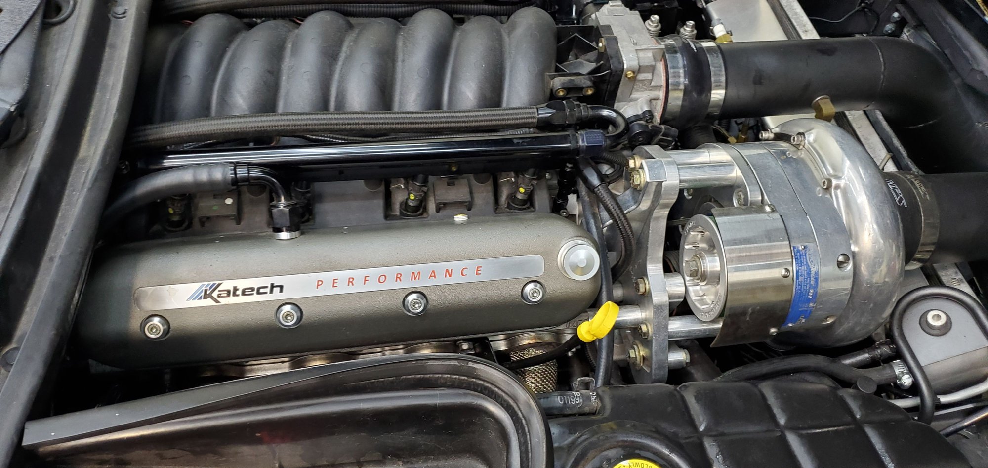

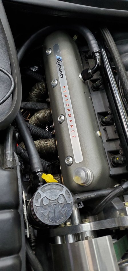

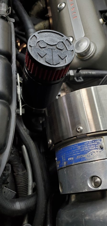

I did a custom mighty mouse setup. I personally cant stand the looks of the oil fill adapters, and wanted something that could vent off a bunch if needed. Its mightymouse pvc boost can., So engine vacuum will pull in normal crank case vapors. When in boost, the pvc/check valve on the can keeps boost from back-feeding the can. The can's vent the opens up to release blowby.

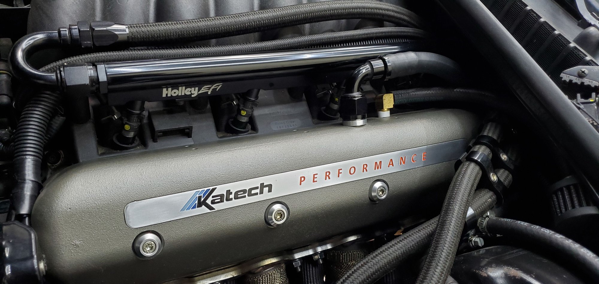

I have -10 lines to baffled fittings welded in valve covers.
Passenger side feeds mightymouse can. I have a pcv valve and a mini filter supplying crank case fresh air (from driver side valve cover).

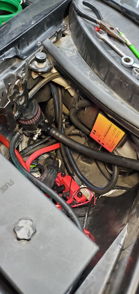

I made a bracket out of aluminum and mounted it here with a MM band clamp style mount... I probably will re-locate it the OEM battery area just to tidy things up a bit, now that I have relocated the battery to the rear of the car. It will lessen the chance of oil fire if for some reason the can where to overflow.
Then, in an all out belt n suspenders approach, i have the driver side valve cover -10 feeding a second (ebay cheapy) catch can at the rear of the car. That line has a check valve on it.
Edit:
Since you got me thinking about it, i relocated the catch can today. Frees up room around the blower for belt change time.
