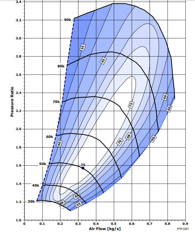

has anybody looked at/used a rotrex blower?

they seem to be less expensive (even with the accessories) than vortech/procharger and keep the oil cool. this is their largest 38R from what i understand, so a bit bigger than v1 ti (0.5 kg/s = 860 cfm)? they are using a separate oil system incl. filter, cooler, (reservoir?) and hoses. i wonder where it all would go in vette.

"If it was me, I wouldn't probably selected that one, at least for Vette."
what are the reasons? one of the interesting features is that it gets fed cold oil.
