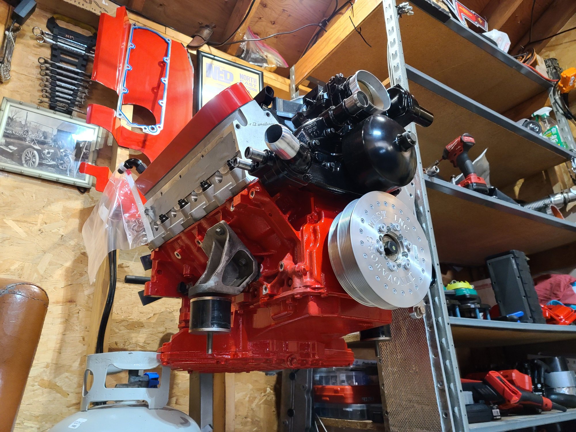

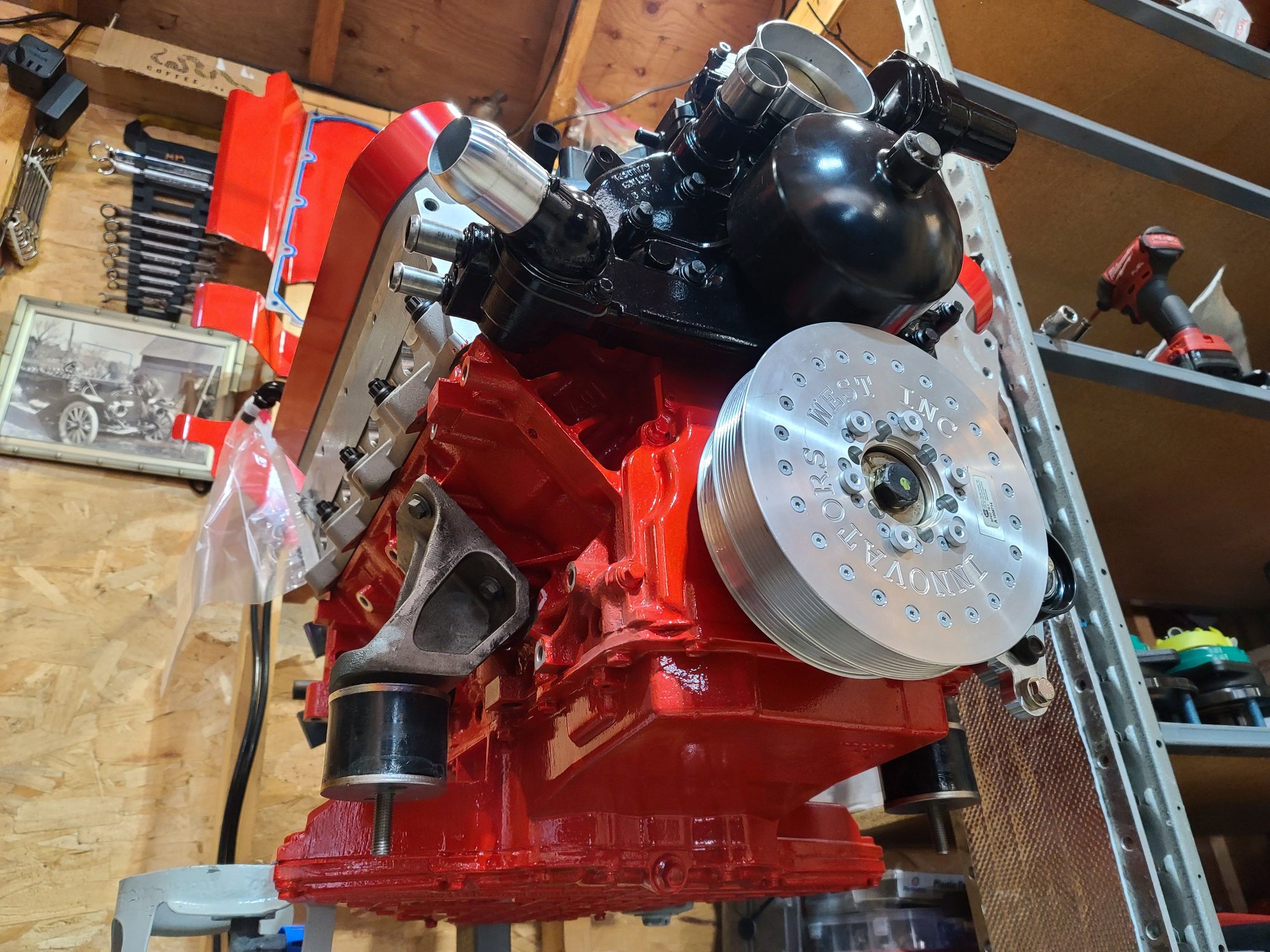

Ok. This one is funny.
I checked my order history and I have BOTH. 251-744 and 252-846. And FML.... but I don't remember which is which anymore. I replaced the pump on my daily last May when I did a SLEW of long-term maintenance updates as pre-emptive work. My current thought is that the "pro" went to the daily 99 and the OE is the nicely painted one sitting on the engine stand. I hope it's the "right" one since I've already painted the piece and had the end of the pulley spot welded to the shaft.
Now I've got to google the oe gm part number. Can you read it zoomed in there? I figure the fact that it has a GM stamp on it is a good sign.
