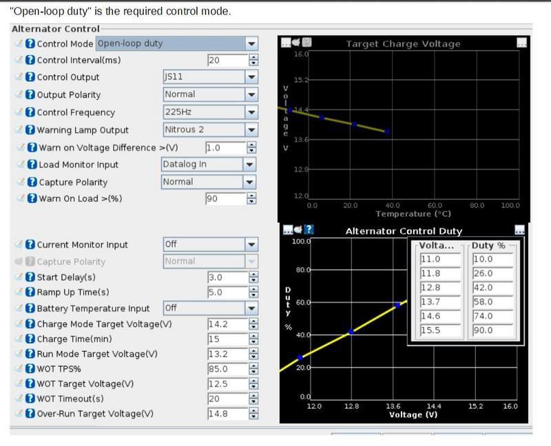

Do not rely on alternator voltage to supply fuel for powerful engines.
When the alternator fails, the engine could be damaged.
The fuel system should be able to support the power output at battery baseline voltage 12.45v to 12.55v
As long as you calibrate the flow requirement for the system and select a pump that produces adequate flow at the lower voltage there’s no downside to running at 12-VDC vs 13.5-14.0 VDC.
Brett Clow
Tech Director
Aeromotive, Inc.
7805 Barton St.
Lenexa, KS 66214
913-647-7300 Ext. 109
It is best to tune the engine using battery voltage without the alternator involved.
Modern stand-alone should allow you directly set WOT alternator voltage duty cycle
If the fuel pump cannot support engine power at 12.45~ battery voltage then you should upgrade the fuel pump.
There are other issues associated with alternator output at WOT also which I have not discussed but should be noted, oscillations in the frequency response of electrical devices such as coil dwell and injector delay time which may wander between in-phase and out of phase with the alternator unsteady voltage signal, this can cause oscillations in cylinder pressure due to variability in spark energy and fuel injector on-time during a wot run.
