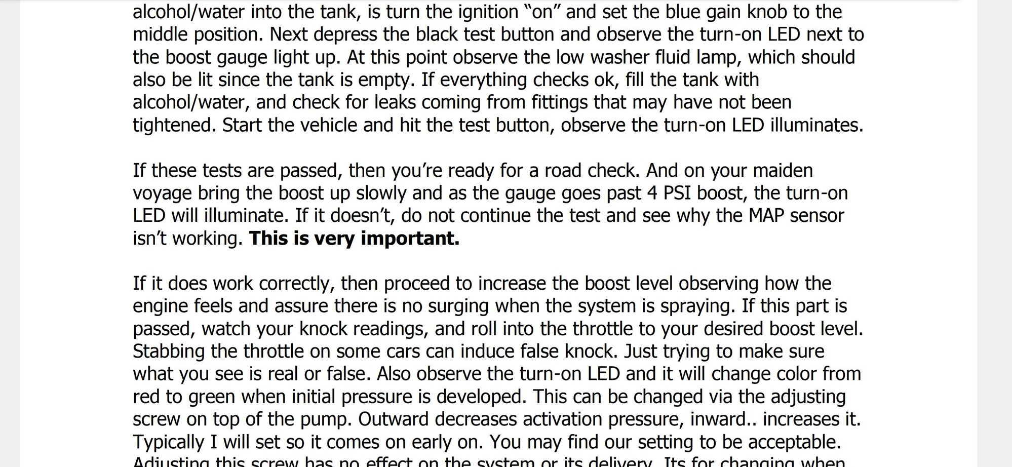

Saw a guy just today on FB saying his light won't turn green during test. Mine never has. It goes full green when it's at full spray. The instructions say it should be red at 4psi and flips to green at full pressure, which can be adjusted on the pump itself.

I've got this kit and I love it. The customer service is exceptional. As stated for "test" the light comes on red. Once the pump increases speed the light will turn green. You can adjust the parameters with the control box which would be set up on the dyno. mine is installed where the battery used to be. The other controller is used for varying atmospheric conditions and should be accessible. Mine is in the glove box.
You wouldn't want the pump to go to full speed/pressure until there is sufficient demand. There is A LOT of spray at that point. The only time I use the "test" button is for drag racing or similar.

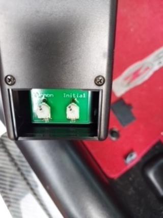

I had the same problem you need to adjust the initial on the controller. Mine was set low Initial is your problem
It’s way down
Move it to 1-1:30
