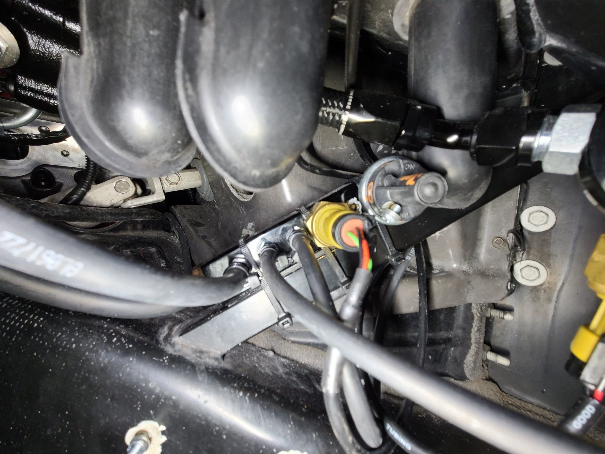

I installed one recently and was very happy to be able to limit and control the amount of vacuum feeds needed on my setup. I like to keep the engine bay clean while also keeping parts easily accessible for service if needed.
In this case it meant mounting the block behind the driver fender on the support frame. It is securely held with double sided tape and then also a few zip ties just in case.
