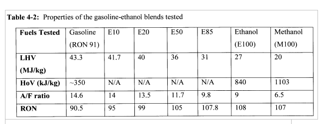

on second thought, you dont need either with a 3.6 pulley. i have been driving a 3.08 for years on 98 ron/stock balancer. what gas is available to you?
actually the "effective" octate number seems to be done at 30% ethanol.
edit: "effective" including the cooling effect from latent heat.
