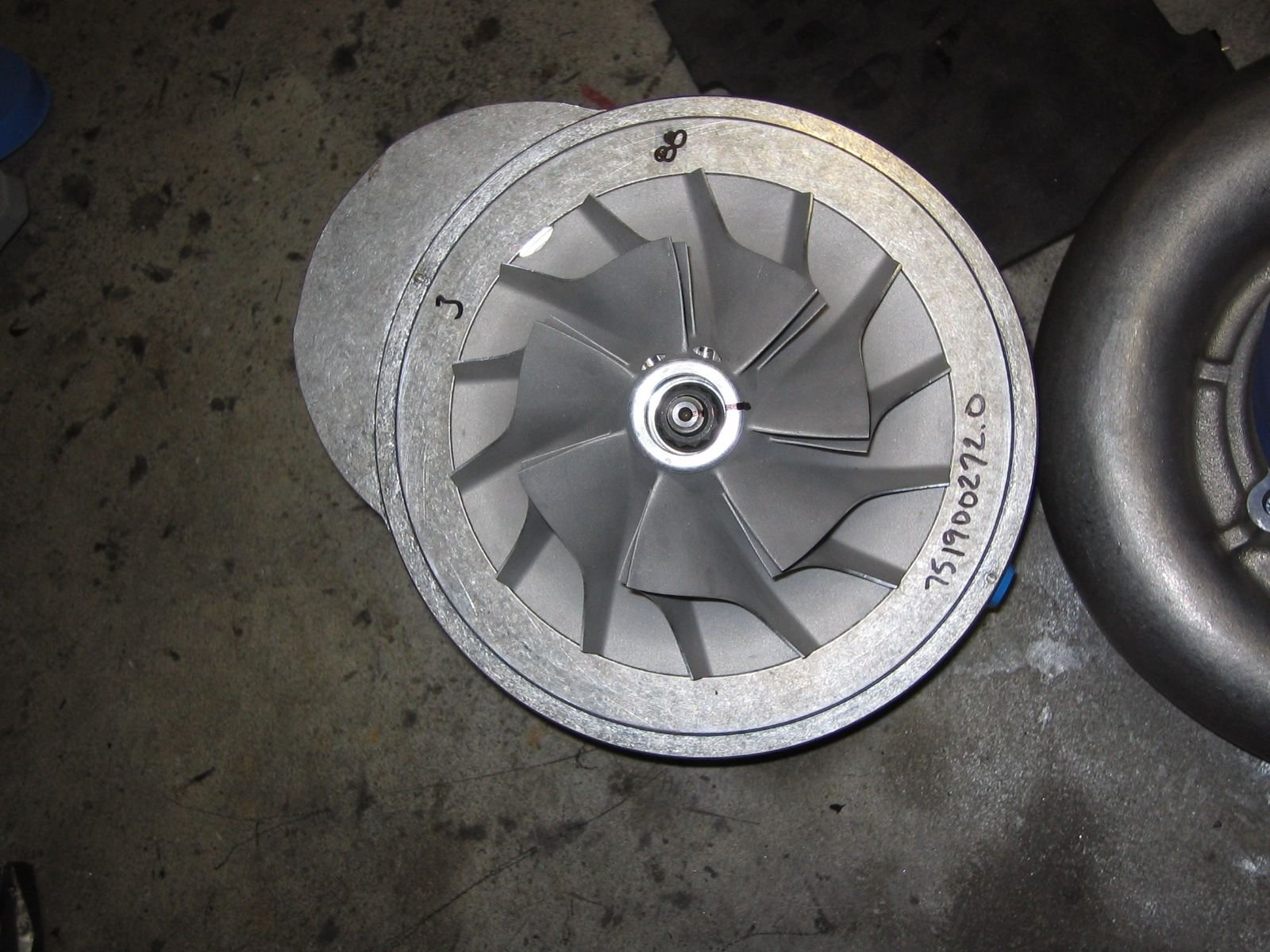

Yes there is oil inside the gearcase. Yes oil potentially could get to the back of the impeller, and then to the compressor discharge as it rotates. But for the oil to get to the inlet of the blower, it would be like the oil trying to climb Everest with a hurricane and gravity blowing it back down.
It just cannot happen. Everything in physics is preventing it.
So oil anywhere else in the blower may be possible, but at the blower intake is the least likely place the oil could ever reach

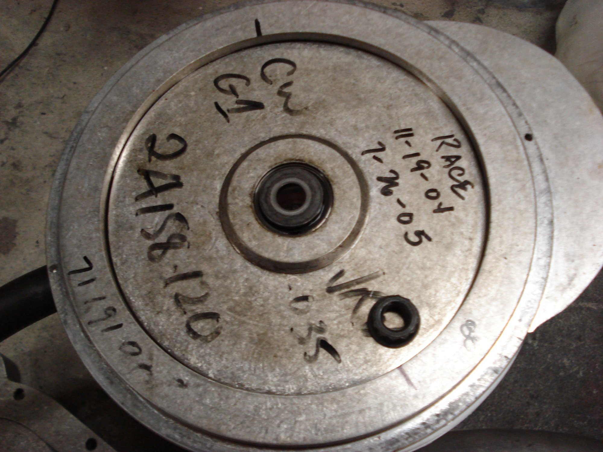

the only seal in this area is behind the wheel for the shaft. Any oil that does get past it, will get flung out the back of the impeller towards the volute. There is no possible way this oil could ever make it back to the inlet.
And the impeller is a press fit on the shaft, there is no way the oil could find it's way down that shaft...again, because everything is wanting to fling any oil outwards towards the volute.
Seal for the shaft behind the impeller
