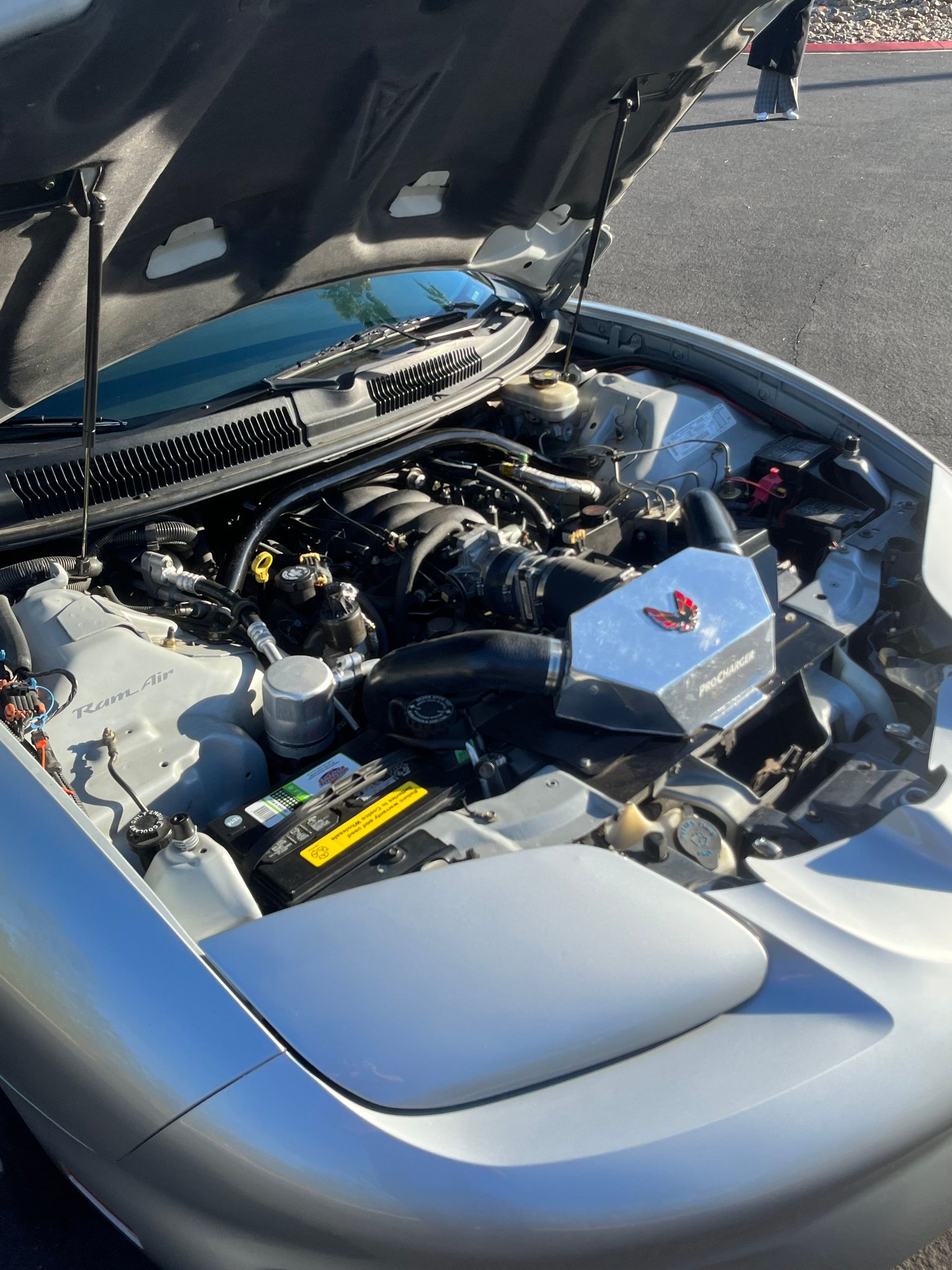

Yes, tune it .... I used HP Tuner and stayed with 7.5psi. It gets you smog legal and produces 500HP plus. Safe reliable power for over 40K miles.
If your plan is the fastest..... It may not last,,,, I went conservative and still blew out Centerforce Clutch rated at 500HP.
I now sport a 750HP Centerforce Clutch that squeals until it warms up. So,there is some compromise running race components.
Good Luck with your build,
Mecinoid ...
ictu
