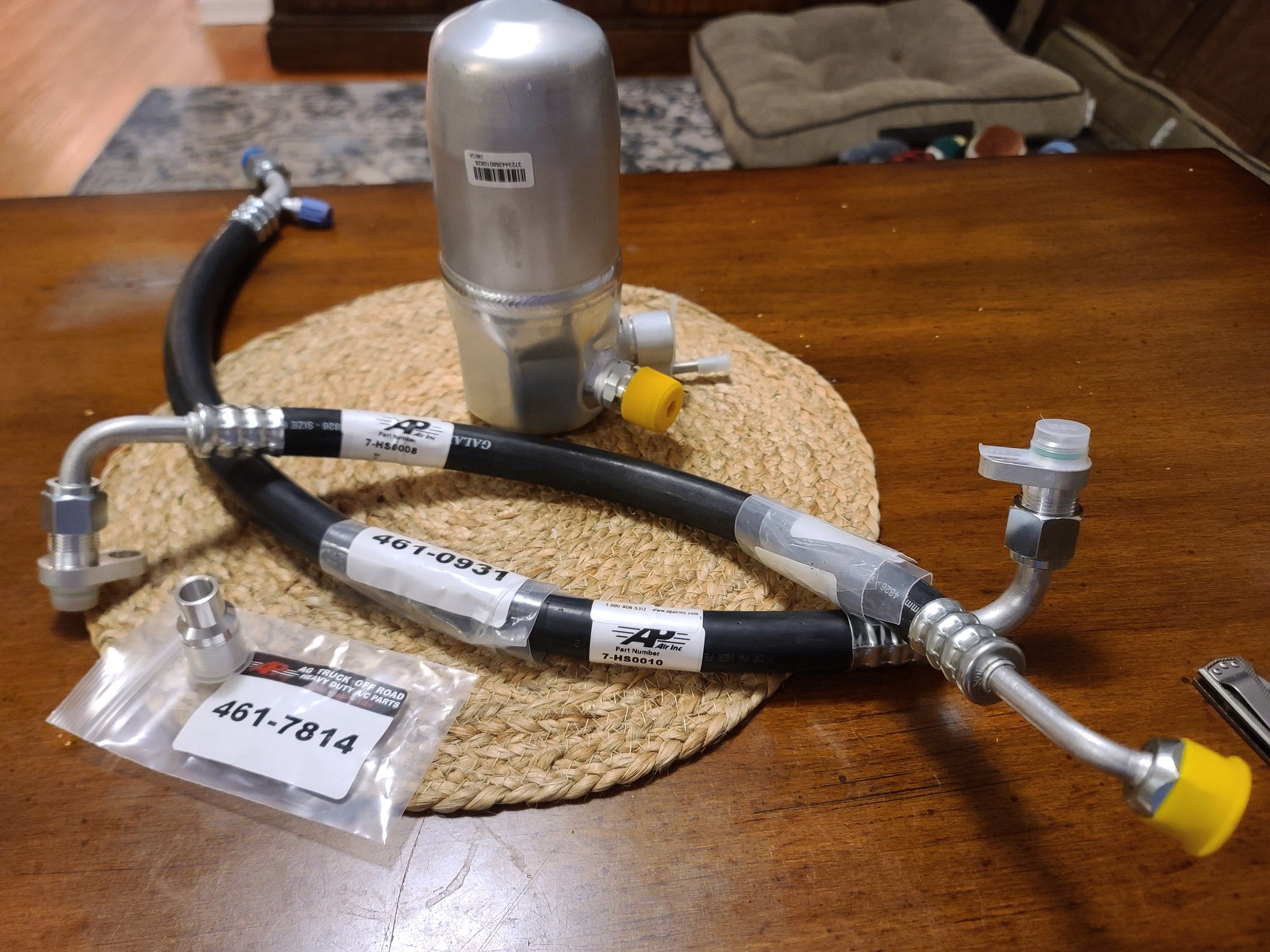

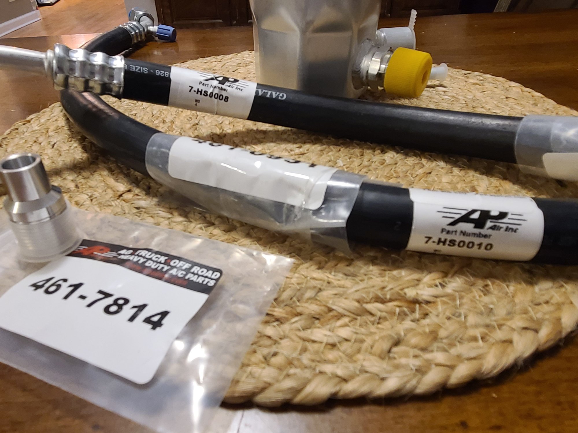

Jon at Huron was able to order me the AC line components needed to convert the C5 to the CTS compressor. Stout lines made by AP Air Inc out of California. They look to be several set pieces for a kit with them. I'd still go to Huron for the business as I did but these parts do show the assembly part numbers. The canister looks to have been welded with the correct adapter. The stand alone threaded adapter in the foreground I have not a clue where it might go yet, but I'll figure it out when I look at the car or review install instructions.
Notably: Made in the USA on the lines themselves.

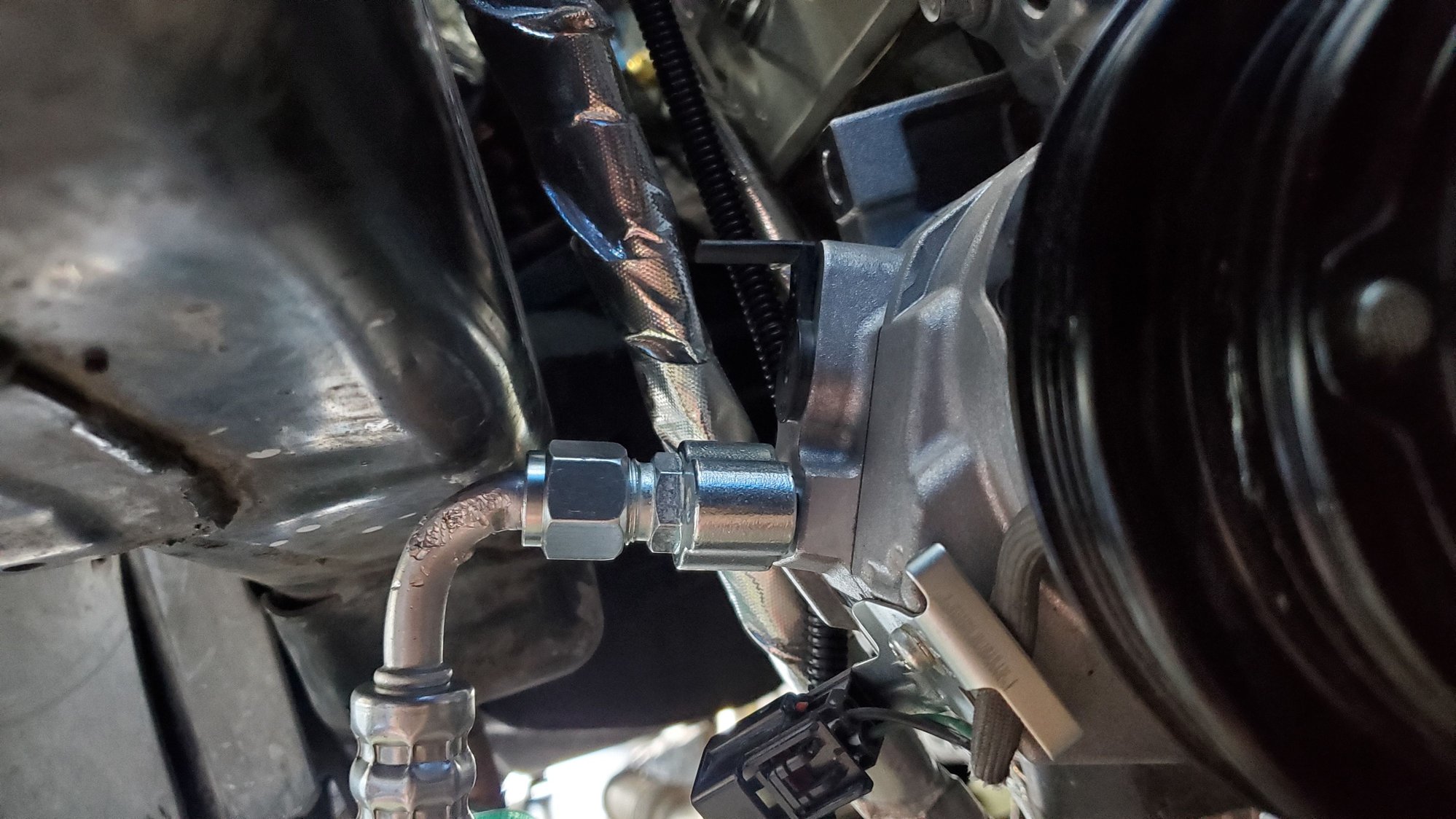

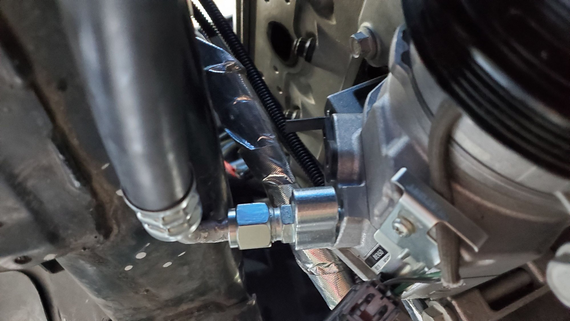

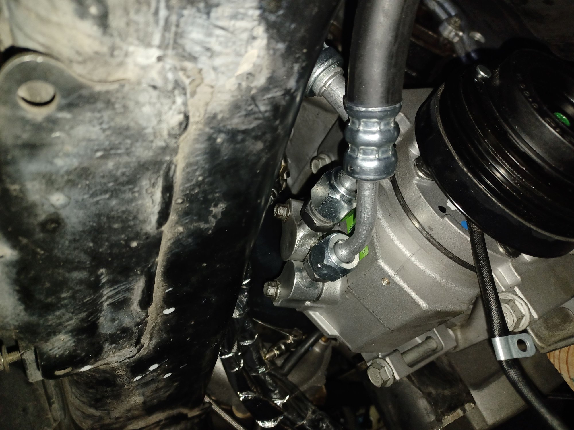

I switched to a truck compressor on mine. I could not get the a/c lines to clear the frame. I also lengthened the line from the dryer to the compressor so it could have more distance from the intake piping.

Made your own lines, or have someone nearby who can? Which compressor part number was that?
OH boy am I not looking forward to finding out things don't clear the frame if that's the case.

Those are the lines and compressor I ended up with to cure my headaches. Have to swap pigtail on compressor and its got an extra rib or 2 on the pulley that isnt used.
Edit: That company can make custom fittings like the ones in the attachment for the CTSV compressor, I dont remember anything about the CTS fittings now. They just didnt have any when I called and no ETA and I didnt want to wait. May have been during Covid so who knows when **** would have showed up. Theyre local to me and very helpful with what I needed when I called. Itll be a good contact to have if you run into issues with anything. At least you know theres options.

Ah. I see. I could potentially use the other adapters to have the hose come in from the front then. I wonder if I would have sufficient length of hose.

Those adapters are pushing the connections way too far out. We could certainly find some really shallow connectors. Secondly, we could also get some hard 90° fittings which would allow you to run a straight hose connector. I could also help you with making any line you need. Don't sweat it!
