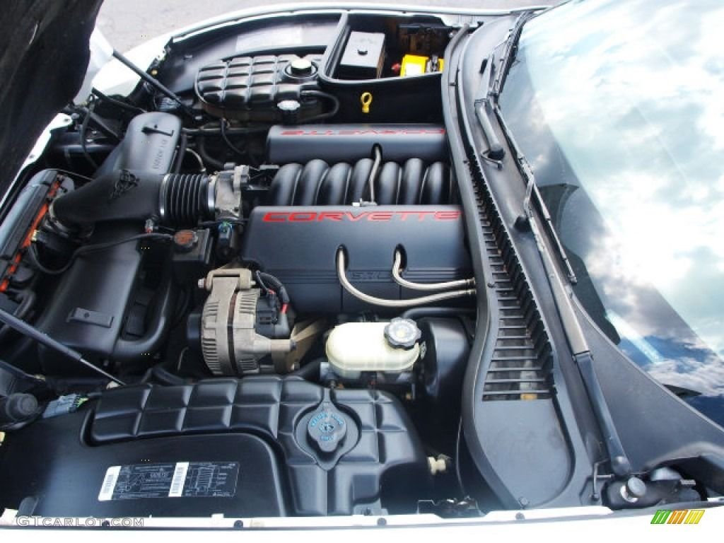

I realize it's an old thread, but I've been trying to find for a while to what slots the post refers.
It's talking about the fuel line slots in the fuel rail cover. Made it easier to remove.
