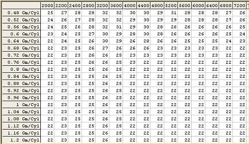

The Stock Timing is shown below. I am not sure how you are able to assess that the car is quicker. Seat of the pants is a very poor indicator. A perfect tune on an airbox-only car is worth maybe 10-15 HP and that is pretty darn hard to detect on a 405 HP car. I personally can’t detect that.
Spark knock will put dips in your HP and Torque curves. It is easily visible on a dyno sheet. If you really want to see what your car is doing you need to put it on a dyno. It is human nature to think that your car feels faster after you spend $400 on mods. People that have dyno tested the hand-helds have found that they provide no gain and sometimes a loss. Every car can be a bit different so for real results you will have to dyno tune and read OBDII data with a real logging scanner.
That's because you are only considering peak HP. I am also considering partial throttle and responsiveness. WOT max power is not all I'm looking at. I drive different cars all day, and I'm very much aware of subtle changes in drivability. I'm waiting to see if when the effects of resetting the ECU wear off if it tames back down to where it was, stock again.
If I'm not seeing any timing retard and the Predator timing tables are more aggressive than stock, would it not be resonable to assume it is making a little more power throughout the powerband and not just peak?
