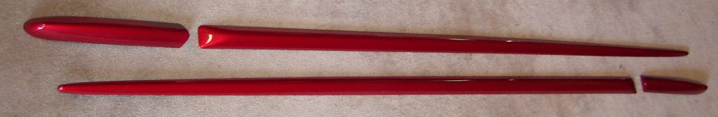

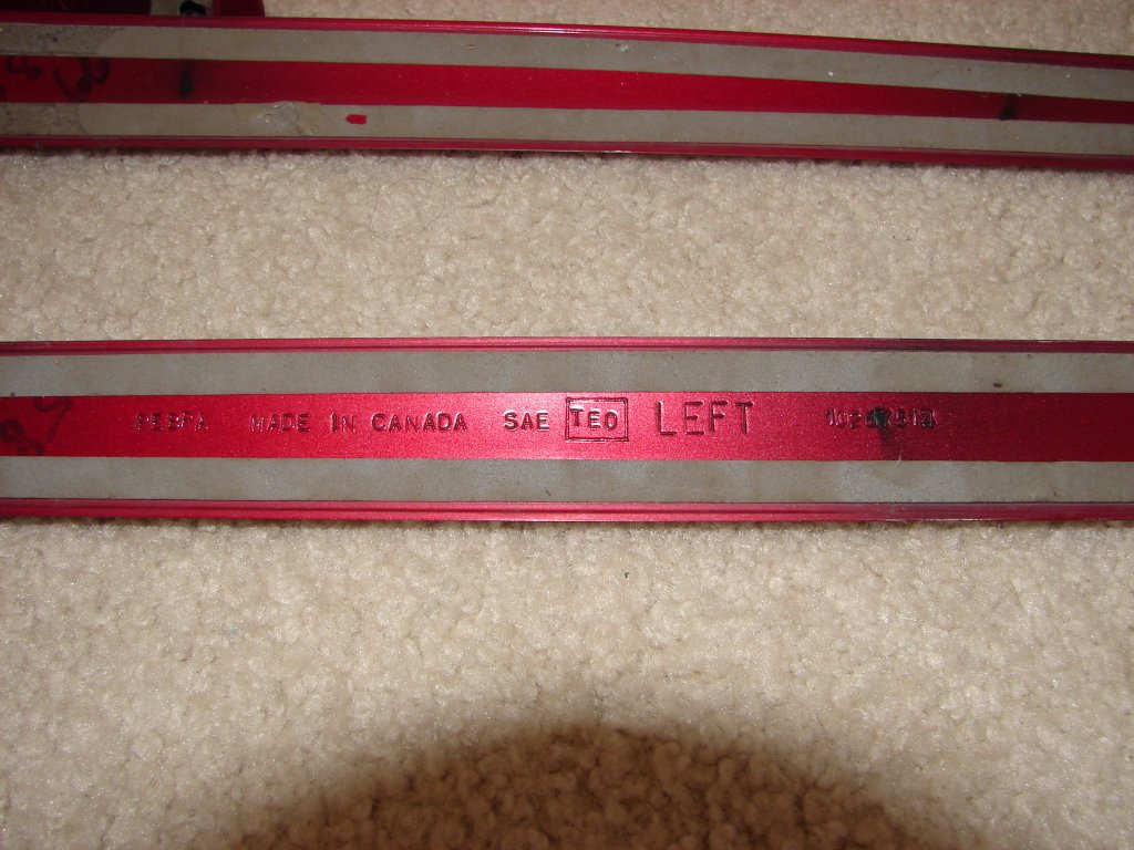

I just removed my BSMs. You guys were right...you can't even tell they were there!
Here are some additional tips:
1) Wash the BSMs and area around them before beginning.
2) Start at the front where the molding is widest.
3) Use a blow dryer to soften the adhesive a bit, to get the fishing line started. You do not need to keep using the blow dryer, once you get about 3 inches down the molding.
4) Keep pressure against the car on the top part of the molding to preserve the molding top edge, in case you want to later re-apply them or sell them. No one can see the bottom edge, so no worries there.
5) Once you get enough of the molding unstuck from the car, just get your fingers under the molding snd start peeling the molding by hand.
6) Stick with the fishing line for the small molding on the front fenders. Due to engine heat, they are not adhered nearly as well as the molding on the doors, and the fishing line will cut right through the sticky tape quite easily.
7) Once the moldings are off, use a blow dryer to heat the remaining adhesive tape as you roll it off with your fingers.
8) Use 3M Wax, Tar and Adhesive Remover on a rag to remove any residue.
9) I used Amway Mint Condition polish after the residue was gone, then applied Meguiar's Clear Coat Wax as a final step.
The car now looks longer and lower - I guess it looks the way the designers intended it to look. I never noticed before, but when viewed from the side, the top lines of the body actually "swoop" downwards in the middle which attributes to the car's low look. I never even noticed this before, probably due to the BSMs detracting from the overall shape of the car.
2001 Magentic Red Coupe, factory installed BSMs, and no problems removing, and NO signs of any color difference.
What was very interesting was that when I washed the area later to polish and wax, I noticed the water beaded off immediately from the area where the BSMs were. I wonder if the factory actually waxed the car before putting the BSMs on. Naaahhhh, couldn't be, cause that would've cost money, and if they wanted to spend money, they would've given us lights to drive at night!
I am happy!
