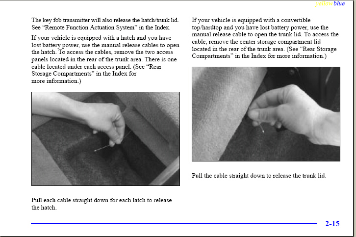

Does this help? Dave
Those pictures are for the coupe. I believe that he has a convertible. The illustration that he needs should be on the next page though.
Yes it is... I believe your referring to this page: Precisely what he needs!
Convertible/Hardtop is on the right side of the page above... Coupe is on the left.
Hmmm. you're right - your owner manual is different than mine (which is a 2002). In mine, it gives conflicting information about where to find the manual trunk release. It has both the paragraph in your pictures, and a paragraph as follows:
There is a glow-in-the-dark trunk release handle
located on the rear wall of the trunk below the latch.
This handle will glow following exposure to light.
Pull the release handle down to open the trunk from
the inside.
The illustration that accompanies the paragraph indicates that the handle is NOT in a compartment, but just on the rear wall of the trunk.
To see which paragraph is right for 2002, I went out to my car and looked. Mine has the glow-in-the-dark handle on the rear wall of the trunk, and no cable in the center compartment. I'm assuming that earlier cars had the release in the center compartment, and later ones had it in on the rear wall. I suspect that this change was brought about by laws requiring that trunks can be readily opened from the inside, so that people can't get stuck inside of trunks.
It would be interesting to know in which model year this change took place.
