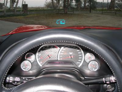

How difficult is it to install the aluminum/stainless steel bezel rings on the instruments? How do you remove the clear plastic lens covering all of the guages?
Anybody have preference if there stainless steel or aluminum (other than saving a few grams in weight )? Any recommendations on vendors?
Thanks guys,
DKHIGHPERF

I bought mine on eBay for like $75 + $5 shipping. Search ebay for "Corvette Gauge Bezel". Try the links John suggested and http://thelapd.com/bezel.htm . There are more links out there. I did mine when I did my HUD retrofit. The clear plastic just snaps off pretty easy when you get the instrument cluster out. Once you have done this you could do it again in a couple hours, maybe less, but tearing it this far apart takes huejos! Check it out.... Dave

I had a good time doing mine.
I planned on an afternoon to get them done but only took a few hours, including interruptions.
Patience is key here. If you take your time then it will be a much easier job. Do it on a weekend when you don't plan on driving it, that way you won't rush yourself.
I have the aluminum bezels. They are lightly brushed. And, they greatly improve the appearance.

Just installed a set of aluminum guage bezels in my 03 coupe a few weeks ago. Finally pulled the trigger on some VetteEssentials goodies for the interior and figured while I was at it I would install the bezels.
I originally wanted to order from Ken at VE but he does not carry the bezels any longer. Picked up a great deal on them at Xtreme Motorsports, supporting CF vendor. Ken King's install instructions on the Vette Essentials site are excellent. In my opinion, this install is not for the faint of heart. If you are mechanically inclined and have steady hands and plenty of time, you can do it. My best advice is to take your time. It is going to take you longer than 2 hours. You better figure on the better part of a day if you want it done right.
Gluing the bezels in place is the toughest part of the install. You only get one shot at it and you have to have the hands of a watchmaker. Just take your time and do not sweat it. It is fun and rewarding mod. Good luck with it.

I cleaned the back of the bezels and the trim rings with denatured alcohol and a q=tip before i did the glueing.......... figured I'd take the time long as I had everything apart. Don't want to be taking it out again and hope this made some sense...........

I had to take mine apart a second time to go in and clean up all the glue that was on the black area. It seems I had glue on my fingers and it got all over the black area creating white spots. It cleaned up perfectly with some acetone and a Q-tip. Guess I at least got plenty of glue on the rings as they have not fallen off yet.

Used Vette Essentials directions- they are dead on. Just follow and don't force anything on or off. Also. test fit! I had my wife actually put the bezels on - smaller fingers. Used crazy glue gel instead of liquid. Don't put to much glue on and follow directions on which angled surface to put it on. I had also read that you should not reassemble plastic cover for 45-60 minutes because the glue emits "gasses" that can fog up the clear plastic. Dont know if its true or not, but did it anyway.
Total time about 2-2.5 hours.
