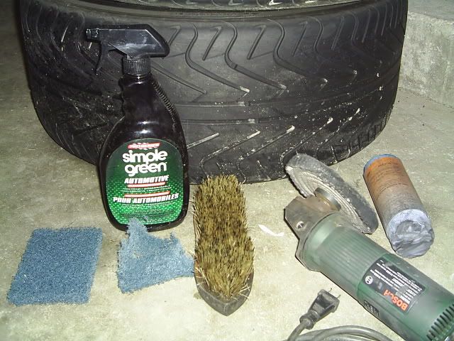

^^^^This is serious polishing. Great job. This is after looking of pictures like theses that I started my polishing 101 self training. Did you do the knuckle? My corsa hide most of the suspension parts. The knuckles are visible when the car is in the street. This is what I like the most. Maybe one day, I will be able to get it done like yours... I need to the the middle part at the EBTCM and the brackets now...
Originally Posted by shakainc
I've been thinking about doing that to mine. What did you use?
I use simple green + pressure washer + compressed air for cleaning. I start with sand paper then I use a grinder + a rag disk and a polishing stick I bought at local auto part store.

I use 3M surface conditioning discs, sand a little smoother then buff out using brown tripoli rouge and green rouge for gloss.
You are on the right track. (the white rouge is for fine detail) If you have access to get under it, it will shine
