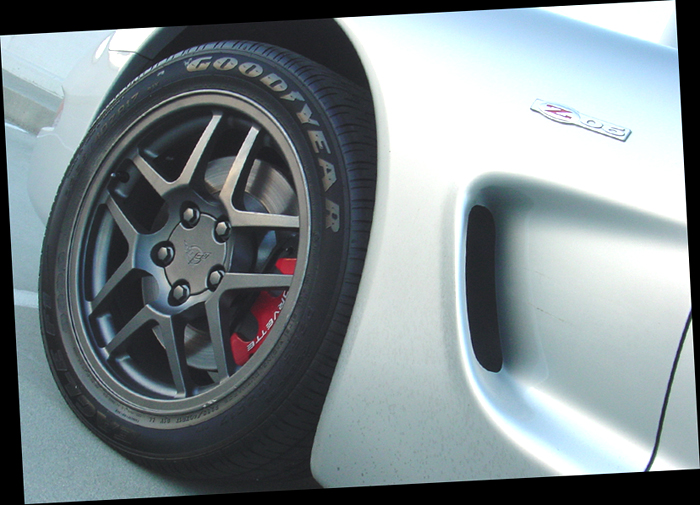

I have been reading many posts on this sight for some time about good looking chrome replacement wheels and how inexpensive they are. I have gone through some extaordinary steps to get Chrome wheels that are the original o.e.m.s but chrome plated. I would like to explain why so you all can understand what you have and what you will get if you trade to aftermarket wheels. First of all my qualifications. I am an engineer and own a machine shop where we manufacture parts for industry, aerospace, medical and electonics, using state of the art C.N.C. equipment. I have been doing this for just shy of 30 years now.
The process used to make the original speedline Z06 wheels is known as spinning. Spinning is a process that has been around for a long time, but has become much more cost effective with the addition of Computer control in the process. In simple terms, spinning is done by turning a billet of material (in this case aluminum alloy) in a lathe and moving the material around with a tool that has a wheel on the end of it. It is similar to throwing (shaping) clay pots on a potters wheel, where the lathe is the potters wheel and the wheel tool is the hand forming the pot or in this case wheel. The processes used most often to manufacture wheels are casting and machining and machining from billet.
In the casting and machining process, molten aluminum is poured into a mold. When the material has solidified the wheel is put on a C.N.C. lathe and turned (Cut) to the final shape. The casting process yields very inacurate parts due to thermal distorsion and shrinkage during cooling. For this reason the wheel must be machined after casting. The other problem with casting is that in the casting process air bubbles can form,and sand or other impurities can be trapped in the casting. These flaws can not be seen on the surface but can significantly weaken the wheel.
In the machining from billet process, a billet ( chunk) of aluminum alloy is put in a C.N.C. lathe and using tool bits (tools harder than the material they are cutting) cut to the desired shape and size. The wheel will also have to go on a C.N.C. maching center to cut details such as spokes and stud holes. This process yields excelent quality wheels but the wheels are not as strong as the spinning process wheels.
The strength of the spun wheels comes from the microscopic grains that make up all materials and thier structure. In the casting process the grains are very random and loosely packed. A billet also has this structure when first poured from the molten material but is then cold worked by pushing it through rollers to shape it and strengthen it. This cold working forces the grains together and aligns them into extremely strong chains. In the machining process these grains are cut, weakening them slightly but still leaving a strong wheel. In the spinning process, the wheel is cold worked into the final shape. this leaves a grain structure that is far stronger than the machined wheel, just like a forged part (which uses a similar process of moving material around rather than cutting to shape a part)and is much stronger than a cast or machined part. A good analogy is to think of a crank shaft, would you rather have a forged crank or a cast crank. Due to this strength the wheels on the Z06 were able to be made thinner and so lighter. Another advantage is that in the spinning process the wheel produced is better balanced than machined wheels and far better than cast wheels which can be very badly out of balance.
The boys at GM definetly went above and beyond on many parts of The Z06, and the wheels are a shining ( but slightly dull in stock powder coated form) example. Anyone lucky enough to get wheels made with this state of the art process stock on thier car should think carefully before tossing that aside for looks. After all if looks are what your after isn't a convertible or fastback a much better looking choice. I for one chose the Z06 for the amazing performance that comes from the complete package that the enthusiastic GM engineers put together for the performance enthusiast.
