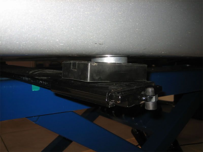

Originally Posted by Ta-taaa
So is the only proper way to lift is to use the lifting puks?
NO, they could have also used a lift where you actually drive the car onto and lift. For that job the wheels do not have to be removed so a Drive On lift would be fine also....
Ex:
