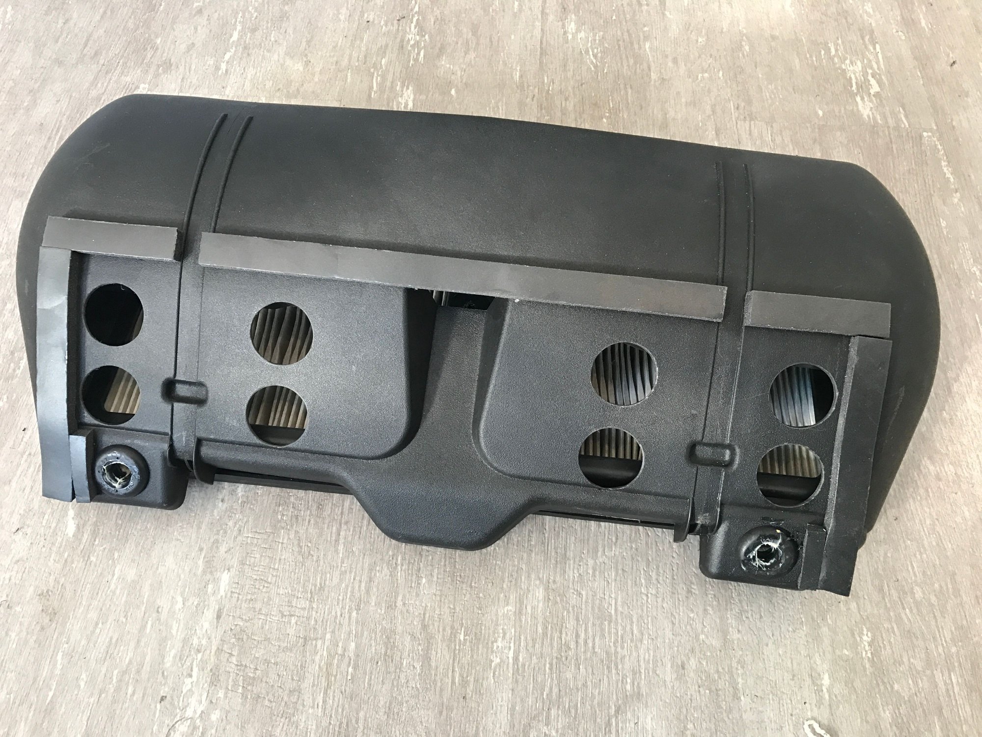

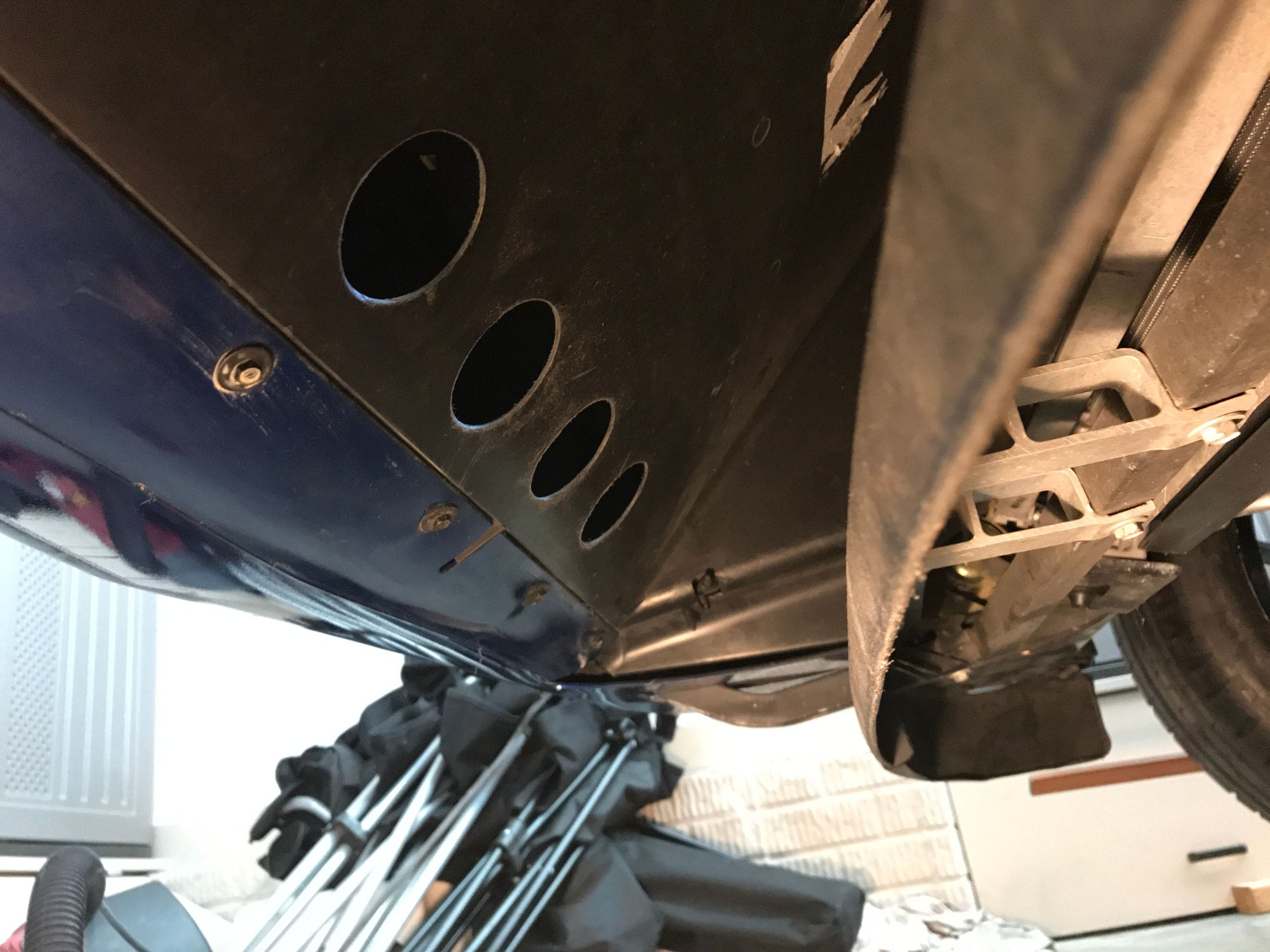

Very unique solution and great write-up! I took a slightly different approach by adding some additional inlets to the stock airbox and drilling some fresh air openings in the bottom of the fan shroud.
How is it working out?
