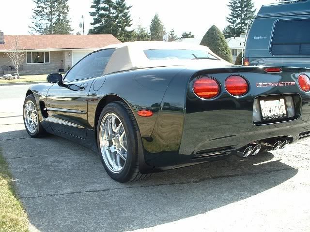

I bought the rubber seal online but it was just a rounded edge weather strip you could buy at the hardware. Bought some spacers and longer screws, works good so far.

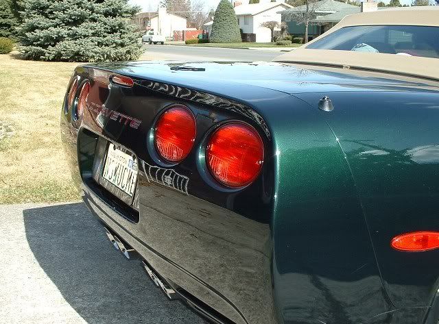

i used md marine weatherstripping, 1.5" stainless screws with black epoxy heads, and 1" and 3/4" nylon spacers from Home Depot, after you line everything up, use some auto wash to lube the weatherstripping so it slides in, it may take a little pressure so the soap helps...here are mine....
