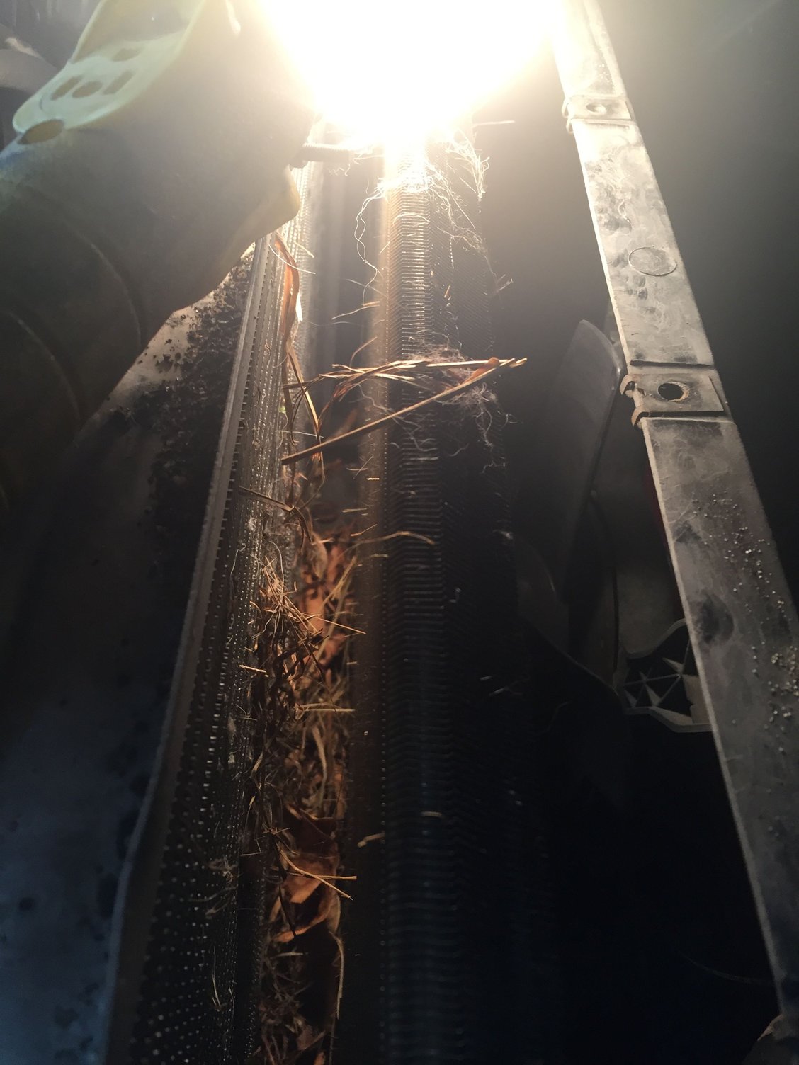

Old Jul 24, 2022 | 11:16 AM
billschroeder5842's Avatar
billschroeder5842
Zen Vet Master Level VII
Posts: 5,218
Likes: 1,174
From: Southlake, TX
I may have missed it, but have you done a check/cleaning of your radiator? Our cars pick up junk fast-- fast. A simple cleaning might improve air flow and solve your problems. This is what I found while making my initial check after buying an 89 a few years ago. Needless to say, a cleaning made a BIG difference.
