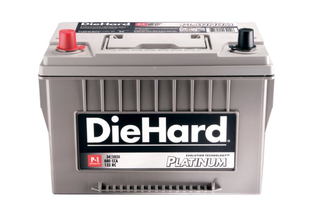

I have the Optima Red Top. Nice battery. Sears recently started selling a AGM Diehard. Pricey but a nice battery.
