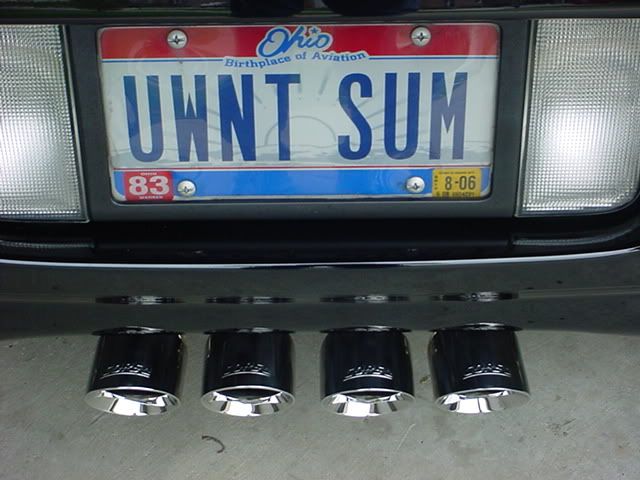

No real issues here....maybe I got lucky!
Old Dec 24, 2007 | 03:53 PM

I just got back from a 40 mile ride. The 65 ft lbs seems to have worked. The are about as good as I can get them for now. They do sound SWEET...
They don't look as good as Ohiostate's above but better then I had them. I'll post pic's later tonight.....
