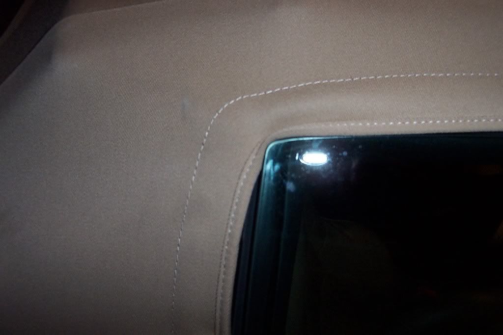

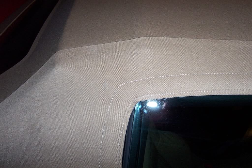

What's up with this? Not sure how long it's been doing this, not long I think. The corner of the top is knicked a little where the window catches it. If you lower the window close the door and roll up the window, it looks fine. You can also carefully pull the corner of the top out as you are closing the door and it closes ok. Can this be adjusted somehow? The drivers side looks very similar but doesn't catch like this one. This is a 98.

I had the same problem, only on the Drivers side...had the dealer adjust the front to back tilt of the window. Now it is fine.

Done, about a turn and a quarter on each adjusting screw did the trick. Thanks again!
