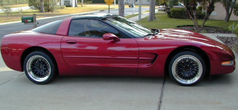

Default Re: Drag radial advise needed (Ranger)
Here is a pic of the CCW wheels that I have in 12" x 17" for my BFGs. Not my car, but those are the wheels I'm running on the rear of my Z06 at the track. FYI they cost about the same as the OEM GS wheels and the are an inch wider, thereby making a better contact patch.
CCW wheel with black powder coated hub
Ranger
