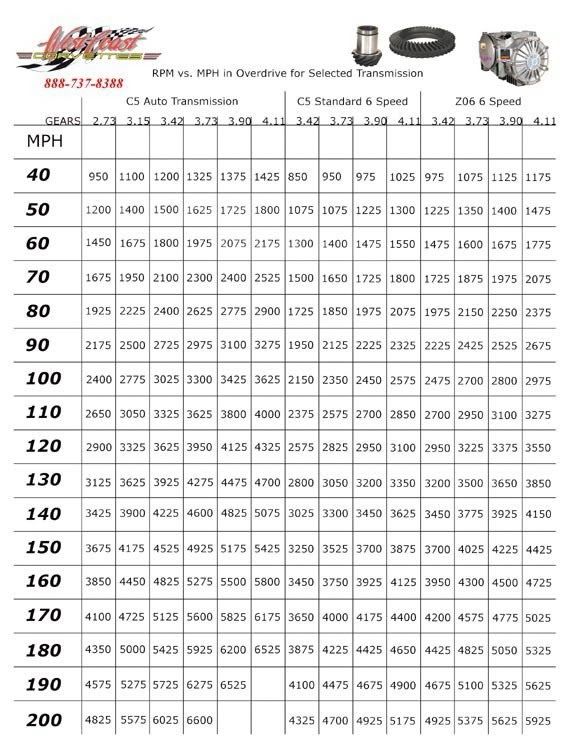

Maybe this will help.
Bill K

Thanks for posting that gear/mph table...I just leeched it for my file
Thanks Bill, that's a good post.
