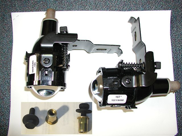

Depends on the intended purpose of your foglights:
There are 2 types of patterns you can get: Fog and Driving. Foglight patten is a wide beam with a sharp cutoff and is designed to give illuminatino for about 15-50 feet in front of you in poor weather conditions. The Driving light pattern is a narrow beam with minimal width designed to enhance long range vision on unlit-poorly lit highways. Great care should be taken when aiming driving lights as they can easily blind oncomong traffic.
Here are the canidates that have worked in the C5 foglight position;
Fog pattern:
OEM foglights (blazer) - Excellent optics for HID upgrade but worthless with a halogen bulb. Reccomended bulb for HID upgrade is 880 series. Has a very sharp cutoff and good intensity but the lens does not fair well against road debris.
Hella Micro De (halogen version) - Works well with either H3 halogen or H3 HID (standard length bulb not H3C or mini) Excellent output and decent cutoff. The lens is VERY durable even without protection like a ZO6 screen or similar.
Driving pattern:
PIAA 1100X - I have no personal experience with these lights, but jdmvette does. see thread: http://forums.corvetteforum.com/c5-g...nvertable.html
Hella Micro De Xenon - Expensive as all get out, but have the durability of the Hella Micro DE with the output of a D2S HID and supurb optics. Minor trimming of the OEM foglight mount will be required for proper fitment. These are the lights i currently use with a 55w 6000K D2S HID kit.

I had PIAA 1100x, and I loved em, cause I hate the popups. They were bright enough (much more the cheezy factory HL's) so I would drive with just those. Trouble was, they burn out too quick ( I also have them on my winter DD), and there is no bulb to replace, but the whole light. So enough was enough, and bought some new oem Vert fogs, and coverted them to 4300K HID. End of last year I updated my ACA HID.'s to 6000K, and also the fogs, but they didn't match, so I'm going back to 4300K in the fogs cause JDMvette was giving me major grief.
Fog pattern:
Driving pattern:
