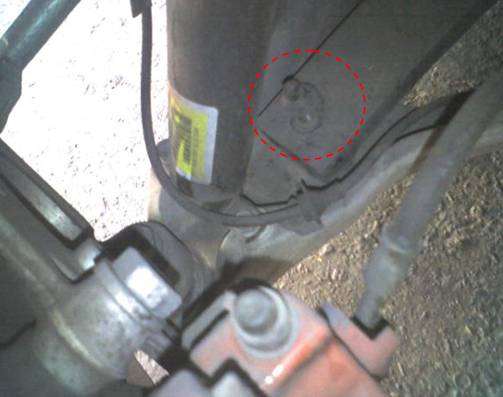

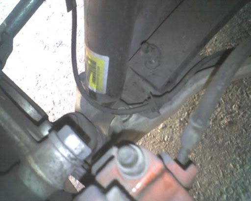

So my car shudders really bad when I brake. It started with a slight vibration when braking due to what I assumed was my rotors. But recently the shudder has been pretty harsh which I can feel on my brake pedals and I can hear a thumping noise too.
While taking off my front whjeels today, I noticed this bolt that did not seem to have a not on top. All I see is a washer which is pushed way out on top. Is this normal ?
I am going to remove the other wheel a little later and see if its identical, but I got some pictures last night from my phone cam and though will try to ask the forum while I am at work.
Here are the pictures. Is this normal? Could this be the reason for the noise and shudder?

That is the bolt you use to adjust ride height - there's one on each end of the leaf spring. It's normal-looking on yours and appears someone backed it off to lower yours.

Looks like the lock washer on the front suspension leaf spring. Normal. No nut. My Z06 is the same way.

I believe that bolt is part of a bumper attached from the other side of the sway bar.

Thanks all. Good news is that it is normal.

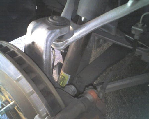

From the picture the rotor appears fine. But we only see a piece of it. Might need to see more pictures, mic the rotor fronts MINIMUM thickness is 30.6mm, discard rotor after 30.3mm, rears 24.9mm, and discard after 24.5mm. Depends on the state of the pad. I would not advise resurfacing or turning a rotor. They are inexpensive around $90 just replacement them. (That is another story, requires more muscle LOL)
Perform an inspection of the other parts. Check alignment. Pedal feeling and thumping noise don't sound good. However it could be just worn pads.
