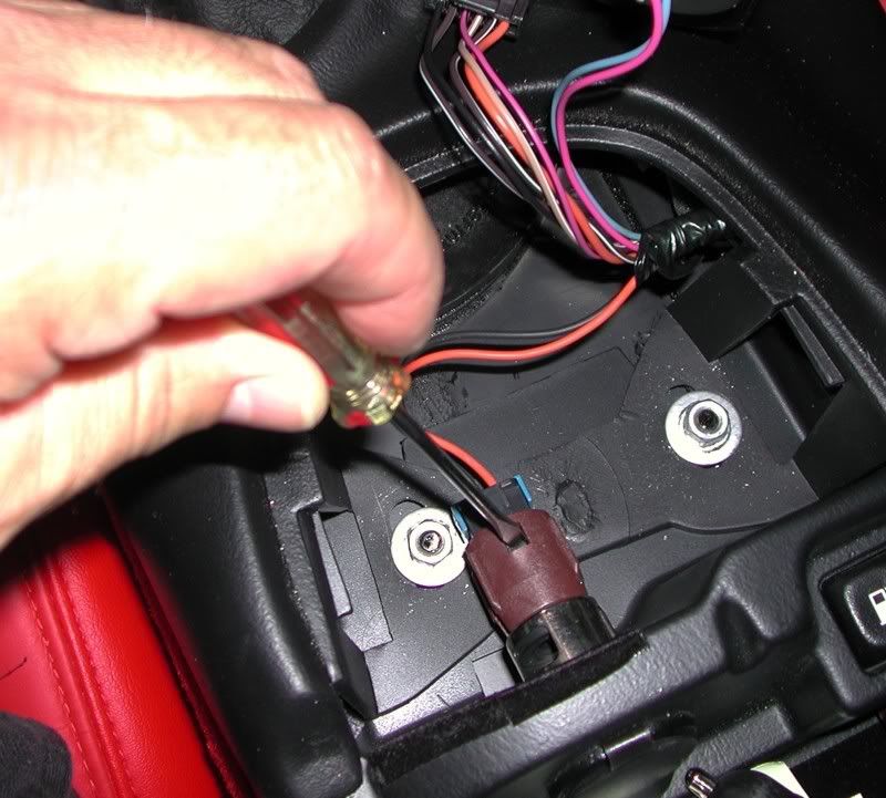

of the "accessory port" inside the console? I'm working my way down to disconnect the "PARK" solenoid and I can't get the connector off. My '98 connector is not like the pics in the vett essentials instructions. It has no tab or anything to depress. My guess is I just need to use a little more force but I don't want to break the plastic connector.

Are you referring to this one? I use a small screwdriver to release it. Maybe your's was rotated 180 deg. by someone in the past and the tab's not visible.

Patches......mine has no "tab" or obvious place to release. Sorry I don't have a pic handy.

Maybe you can release the accessory port itself from the inside of the console to get a better approach to it?

Its easier to take the whole thing out first. There are two tabs that hold it in. You rotate it one way and get one of them out then turn it 180 degrees and the other comes out. Then its much easier to unplug.

I finally got the connector off the accessory port with a little force. After that the job was a piece of cake thanks to several advisory and re-assuring emails from "Big Hank". After I had the shifter boot off I noticed that there is a 6-8 inch pigtail from the solenoid to a free standing connector just in front of the shifter boot. That's where I dis-connected because it's easier to reach. With that being said the dis-connect can be done without pulling up the boot if all the C5s are alike. That would eliminate the chance of breaking the little tabs holding it on.
