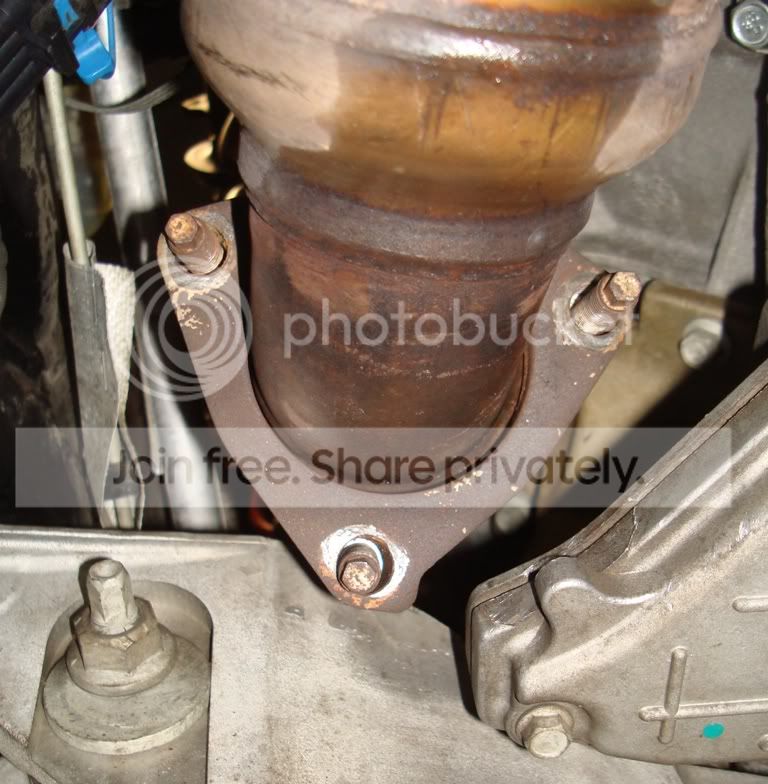

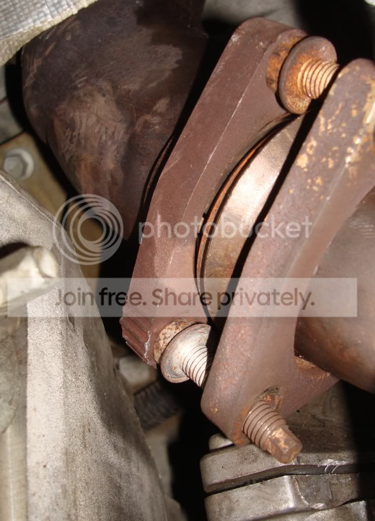

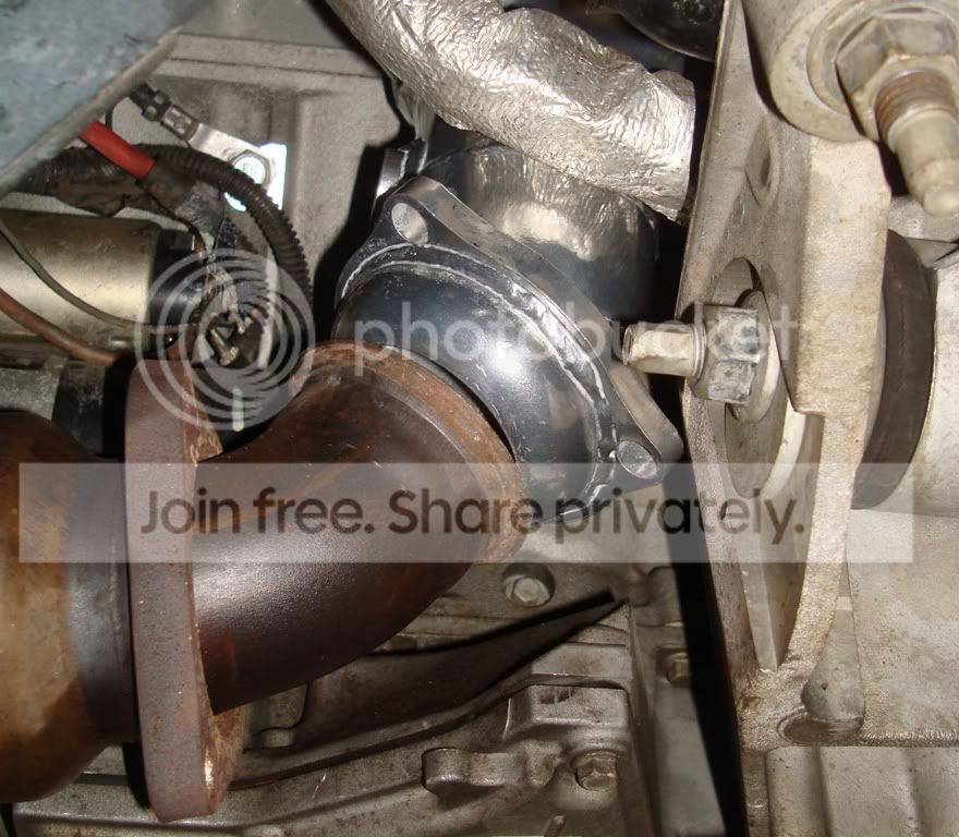

Installation is were it all went bad. My mechanic only got to installing the passenger side when he found they do not fit. The bolt up to the block, but the collector comes out too close to the subframe where you can't get the bolt in. The stock manifolds have a threaded stud and the Doug's use a nut and bolt, but even if they had a threaded stud, the header would bang against the subframe. You can see where the Doug's come out in comparasion tot he stock manifolds.
Stock Manifold

The JBA's didn't fit either, same problem in that they came out the bottom too close to the subframe just like the Doug's. When my mechanic called JBA for some tech advice, he found out Doug's and JBA have the same manufacturer. My mechanic is good and he thoroughly check my car and the original manifold and everything looked fine and the original manifolds were not bent or anything. I know the 2000 C5 exhaust were unique, is it possible the manufacturer who makes the Doug's and JBA has the wrong jig for that header? The Corvette Guys were cool and giving me a refund for the JBA's also and my mechanic was super cool and charged me a minimal charge for all the labor he did for trying to install the Doug's and the JBA's. I'd like to hear if any other 2000 owners had a similar experience. Since this is my third attempt at installing shorty headers and since the hp gains are small, I am giving up on trying to install and futher headers.
