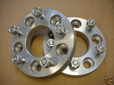

what some of the folks replying in this thread seem to be missing is that you're talking about spacing your STOCK wheels out to flush.
you need something like this for the rear wheels:
http://cgi.ebay.com/ebaymotors/CHEVY...Q5fAccessories
as far as spacing out the front, there's really no need. you can go with a 1/4" spacer at the most.

I used the 1" spacer like the one pictured above to install stock C6 rims on rear of my 97. They work great but I had to grind about 1/8" off the stock studs as they protruded above the spacer. I haven't heard anyone talk about this before and wonder why. It is not very noticeable and would recomend anyone who has used this type of spacer to take a very close look to see if there is a tiny gap between rim and spacer.
