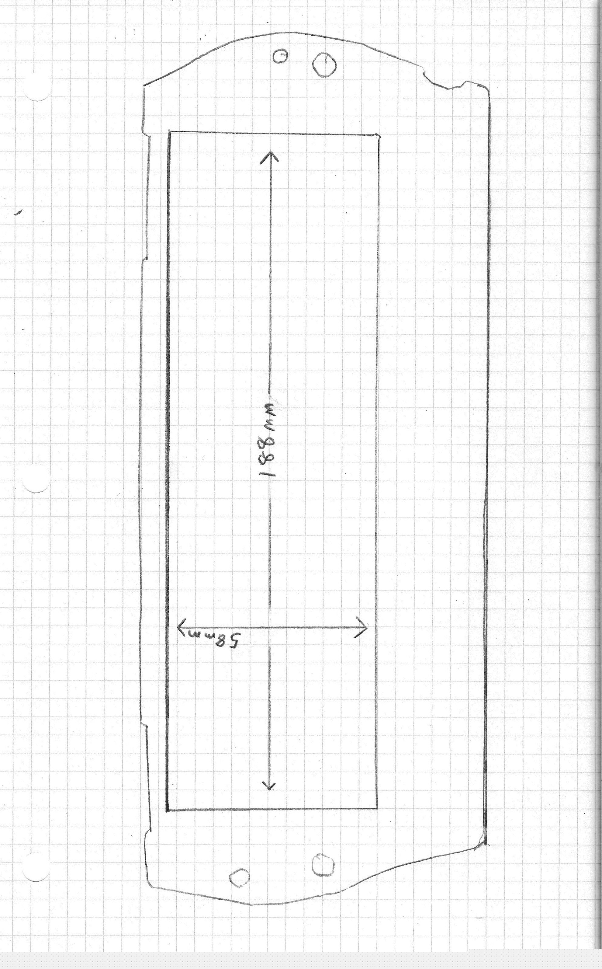

Goal #3. Since I wanted to be able to return the factory radio at will, cutting the bezel for a double DIN touchscreen radio wasn't an option. Not only do I not have the skill to do this modification myself, I also am too cheap to spend the $300-$400 for an already modified piece. But even if I would spend the money, this negates the requirement to swap-back the factory radio with ease.
The factory radio-bezel rectangle opening is exactly 3.25" in heigth. The PTID-5300 screen height is exactly 3.25":
You may think this is perfect; well… it was too good to be true. Since the PTID-5300 display rotates to uncover the DVD player drive, it needs a small amount of clearance to stop any friction/resistance from hampering the movement of the screen. I removed 3/32" from the top inner edge lip of the dash bezel to add this needed clearance. I test fitted the factory radio up to the bezel and you can not tell that it has had this amount removed (which still meets goal #4).
I had to make a backing "filler" plate; used this as the material:
Here's a drawing of it:
http://www.tim-yvonne.com/mikemercury/radio/bezel1.JPG
