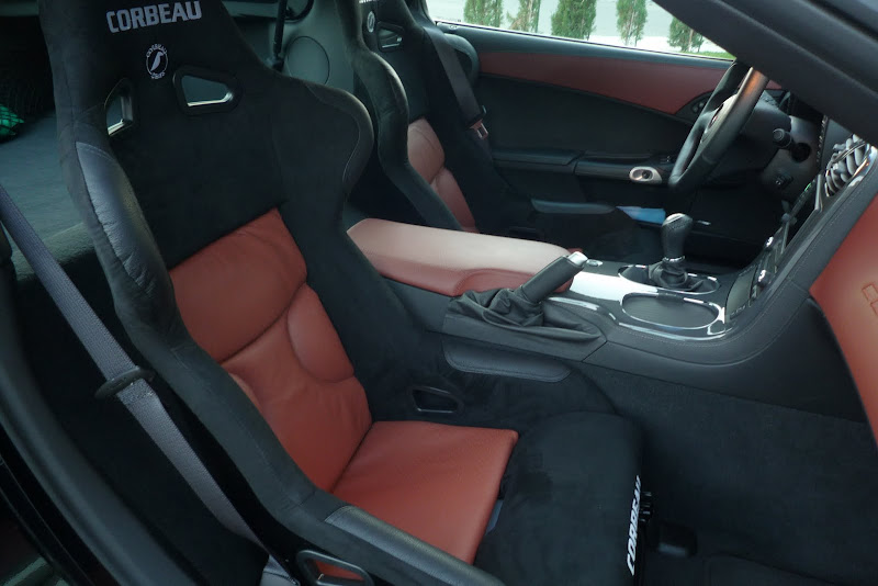

Im going back and forth between shelling out the cash for the caravaggio race seats, or getting a set of the Corbeau FX1 Pros and using the money I save for some other interior upgrades (double din, etc). Anyone have the FX1s? How comfortable are they? Any loss of headroom/leg room when using the Corbeau brackets? Im 6'6 so thats a major issue....I already know that if I go with the Caravaggio's, Im going to need to custom fabricate some adapters to pick up the lost head/leg room. I saw someone over on the C6 forum who got the FX1 Pros in black suede and then had the centers redone in leather to match the burnt sienna interior in his car....looked pretty slick!
Also how comfortable are the FX1 Pros on longer road trips? Lastly, how easy/difficult is it to remove the centers of the seats to potentially have them redone as in the above photos? Any info you guys have is much appreciated!

I had the Pro's and really liked them. I am 5' 10" and I fit with my helmet on and they were very comfortable on long trips too.
One trick I did to help with the head room was to mount them using the Hard Bar mount instead of the higher Corbeau brackets and then some custom work. On the bottom of the seat there are 4 raised mounting points that are about 1.5 inches tall. I sanded the rears down to be flush with the seat bottom and that added some additional head room.
After about two years I upgraded the Corbeau's to a Cobra seat and love it even more. I was attending faster track events and wanted a stiffer seat, so I went with the Cobra. It took some additional custom trimming to the interior panels, but it fits and you would never know anything was changed.
