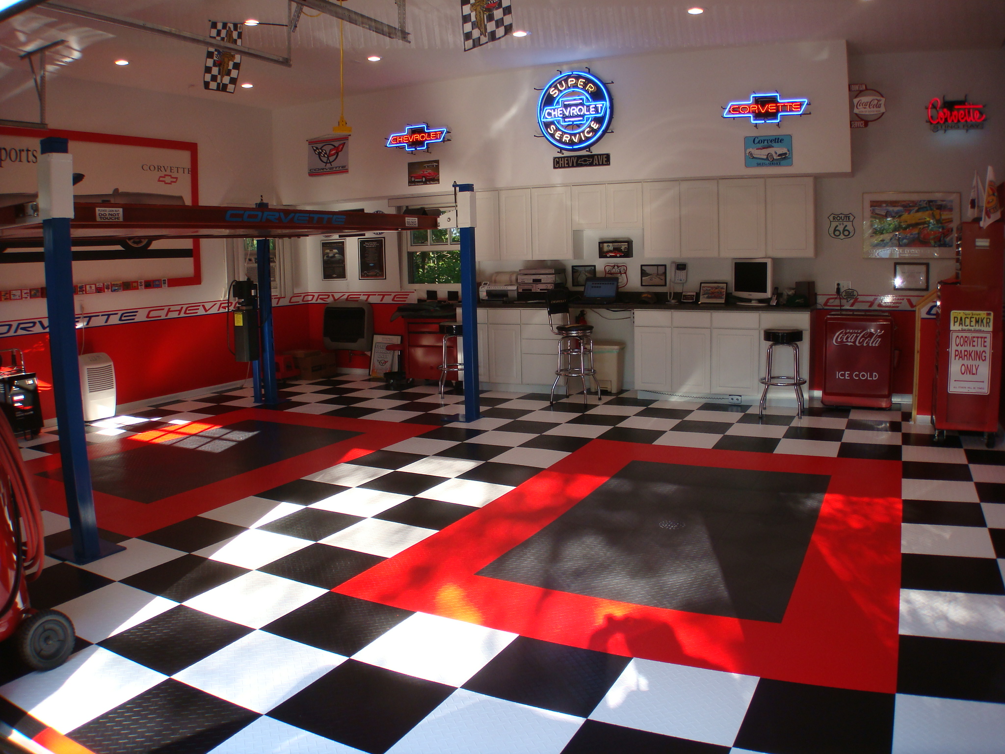

Old pic I have had the Race Deck flooring for 7 or 8 years now wouldn't do any thing else if I was doing it again!

Sherpaboy, that floor & design is fantastically...

Originally Posted by ronssito
I've had both .. prefer the Racedeck tile.
Looks great! I am also planning a Race Deck garage floor for my garage and can't wait to pull up the old rubber mats I layed over the builder epoxy...
