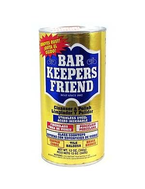

you can use something like Barkeeper's friend
It wont scratch stainless and it is a polish too..
you can find it in grocery stores, where they have cleansers,, Bon Ami Cleanser is a similar product but the Barkeeper's friend is a better product because it has more polish..
You can also use lacquer thinner but it is dangerous to use.. one drop on your paint and you've made a small problem a bigger one... You can Use Mother's Billet polish found at auto stores like Pep Boys.. or autoZone.
