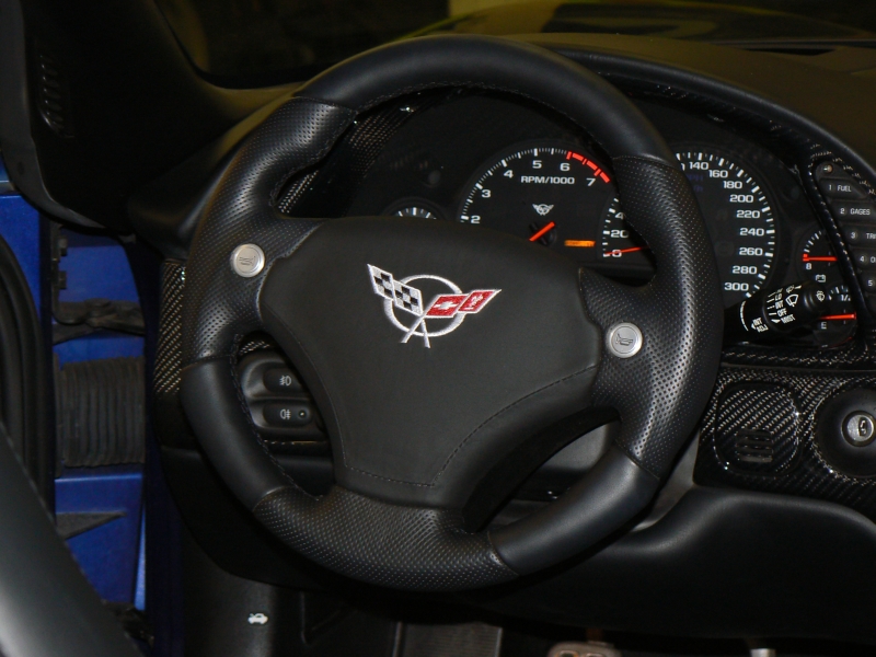

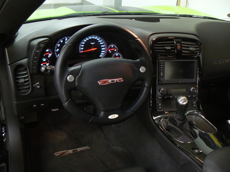

Old Nov 10, 2011 | 04:19 AM
JR Germany's Avatar
JR Germany
Joined: Nov 1999
Posts: 163
From: Ruesselsheim
Hi,
as Frank already posted I have the Raid steering wheel with 12,5'' diameter in my C5 and my C6 Z06.
In both cars airbag covers have been coated with leather and a stitched C5 resp. Z06 emblem which gives a much more better look on the wheel. This mod has no effect on airbag functionality.
Above there are some pictures of my C5 posted by Frank and SoDiezl350 but they are without the replaced airbag cover. Today in the evening I'm going to take some actual photos and post them here.
Werner Moll at www.corvetteproject.de is building the hubs, airbag change is nearly plug and play.
Regards
JR

Old Nov 10, 2011 | 04:13 PM
JR Germany's Avatar
JR Germany
Joined: Nov 1999
Posts: 163
From: Ruesselsheim
Here we go!
C5:
C6 Z06:
May be C5 logo could be placed a little more deeper on airbag cover. Raid sticker on C5 steering wheel was removed easily but on the second steering wheel there was a small indendation for the sticker and so I had to replace it by another one.
In order to produce the hub an original steering wheel needs to be destroyed due to use of toothing with cross-cut in the new hub.
But technical details about hub and airbag wiring should be díscussed with Werner. He is the expert - I'm just a very satisfied user.
Riding pleasure - especially in combination with the sport seats in the Z06 - has dramatically improved. I would never drive a modern Corvette without these small steering wheels.
Regards
JR
