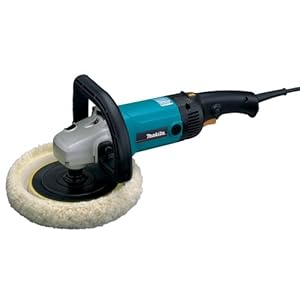

Makita 9227: If you want to go rotary this is it. I have owned this machine for about 4 years and it is very solid. Variable adjustment trigger like the flew. Spins up to 3K rpm. Nothing bad to say about it but it is a rotary and I probably wouldn't recommend it for a new guy.
Pros: works great.
Cons: can leave buffer trails and holograms if you don't know what you are doing (only because of rotary action, not machine itself) Could be dangerous in the wrong hands. (burn through)
And all three next to each other with the Makita on the left, Flex in the middle, and PC on the right.
