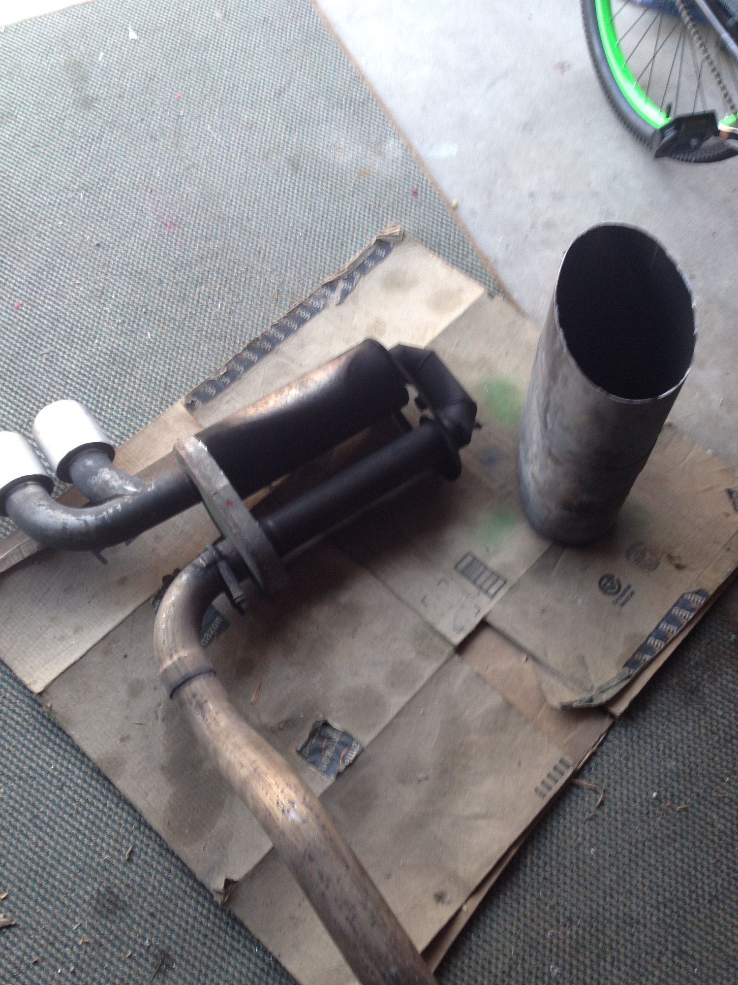

So this is what the inside of a Corsa Sport muffler looks like:
Getting it out was horrible, the cut looks like a hack job (which I guess it is) but thats just the metal lip that folded over during the cutting process.
Most importantly ,you can see at the bottom of the picture on the end piece that it is covered in cracks on both sides. I can almost completely remove it with my hands. It's quite fragile. This must be what is causing the buzzing sound- if you hold it up and tap the muffler with your hand it makes the same buzzing sound. The big pipe on the left is just a glasspack of some sort.
IF my repair job doesn't work, I'm just going to get some mufflers made similar to the Kooks mufflers (http://forums.corvetteforum.com/c6-p...fflers-fs.html). I've measured and they would fit, instead of going under the rear bumper, just straight out under the car out the back.

I know this is an old thread but I was wondering if you can give some more info about how you opened up the exhaust. Did you just cut all the way around the inlet/outlet side and then the case slides off? Or did you have to cut open both sides? I also sent you a PM because I'm not sure if you will see this.
I'm in the same situation that you were as I am not the original purchaser of a corsa exhaust and I have a rattle in the driver's side muffler. Since it is an expensive paper weight right now, I figured I might as well chop it up and try to fix it.

I answered my own question. If you cut around the inlet/outlet side the case slides right off. My pipe connecting to the inlet side had the welds let go. I welded it back together but I will need to take it in to finish. The case is fairly thin and I'm not able to weld it with my skills/tools without burning through it. Here are some pictures for anyone interested. Not sure the exact model of mine but it is one of the early designs for a C5.
