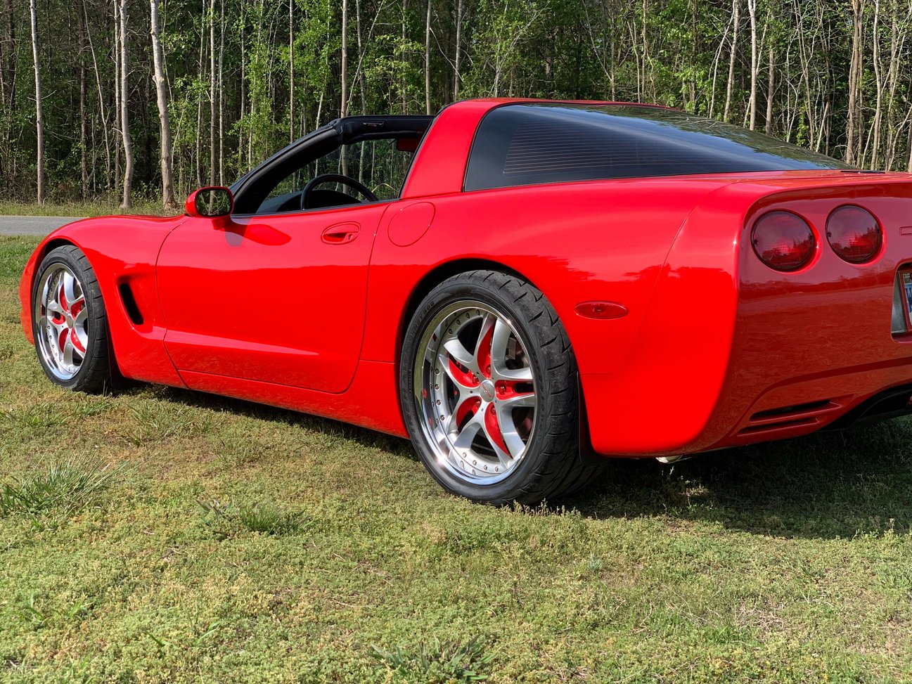

1) You should check the wheel/tire database pinned thread
2) 325/30/19 on 10.5 wide Ronal wheels
-tiny bit of poke
-I did raise it back up a bit from what you see here as it did rub the fender lips on big bumps
-275/35/18 up front, IIRC. Full details in my post on the thread mentioned above.
If you're running a 325/30 tire on 10.5" wide wheels, it's not a recommended combo. The sidewall will be sucked in a bit. Just my opinion...Well, actually not. Most, if not all tire companies don't recommend it, either. Just sayin'...
I lied actually, they are 19x10. BUT I like fat tires, and it's the look I wanted. The car is a garage queen, I have a racecar for pushing hard.
