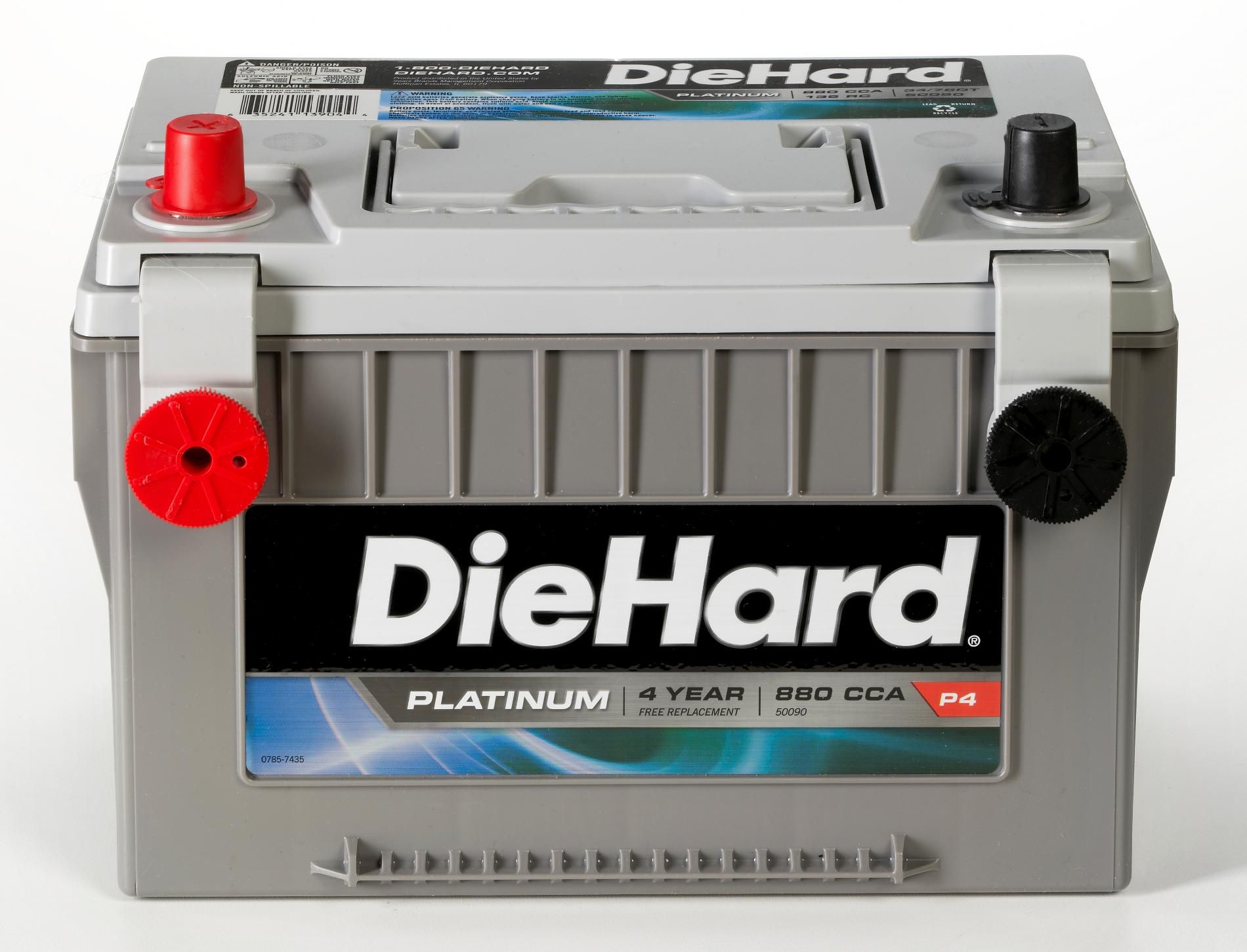

Old Oct 26, 2013 | 11:10 AM
Toque's Avatar
Toque
Joined: Jan 2004
Posts: 20,030
Likes: 289
From: Wylie TX --> Less is More, except under the hood !
DieHard Platinum P4 (34/78DT)
Amp Hours at 20 Hour Rate: 68
Capacity Amp Hours at 10 Hour Rating: 62
Cold Cranking Amps (CCA at 0 deg.F): 850
Reserve Capacity (RC): 135
Battery Design: Absorbed Glass Mat
http://www.sears.com/diehard-platinu...90000P?prdNo=2
