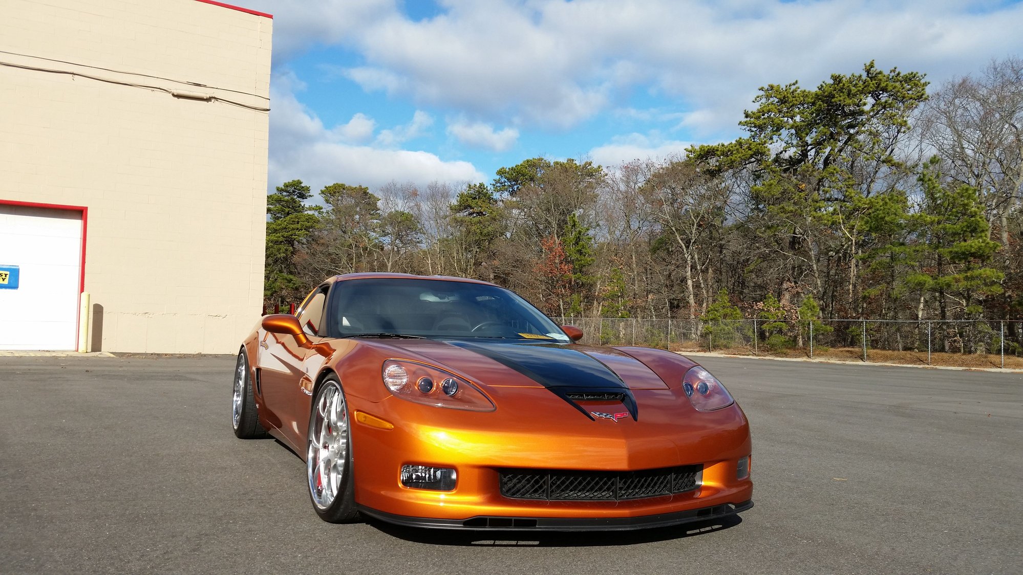

08Z on Pfadt coilovers w/360 Forged Mesh 8's. Pic straight from old phone.

Looks great!. That being said, any reason you bumped a 5.5 year old thread in the C5 section to post a picture of your C6?

I don't know how it happened. This was supposed to be posted in the C6 Z06 lets see your stance thread. No idea how it wound up here?? lol

Twilight Zone stuff right there!
Your car looks great! Perfect wheel choice for that color!
