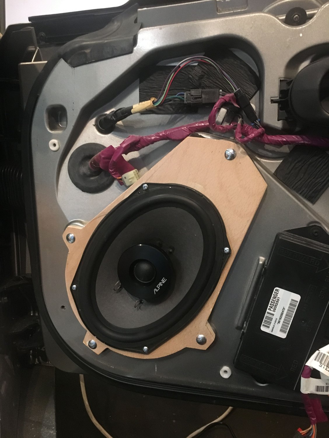

Originally Posted by DreamVetteC5
Want to install Multi Channel Pioneer amp to run all six other speakers, but have been told it is not possible.
If the question is “can I run I multi channel amp” it’s really going to need wired directly to the speakers it’s driving anyway, so I don’t see why it isn’t possible.
It is also obviously going to do away with any Bose involvement. So the answer seems to me, why not? It of course means quite a lot of cable running etc.
I’ve just done it with pioneer 3 ways in the rear apertures and 6x9’s up front. I had to if I want any bass because some clever clogs (at some stage in my C5’s life) snipped the multi plug off that runs the Bose signal processor when they fitted an aftermarket head unit.
So I ran 3 pairs of RCA’s/Phono’s rear deck to head unit and new speaker cabling into the rear apertures and into the front doors.
Here’s my doors now. If of any interest or help I removed the Bose pods and placed clear Perspex over the space in the door. I was then able to mark the Perspex where mounting holes and the cuts etc would be and used it as a template.
